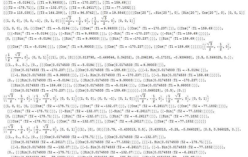

Friends, I have a big problem about Math. the problem is that I have three equations having 16th orders and I got 16 amount roots which have both complex conj. and real parts by solving these equations with the code of the NSolve, up to here It is all ok, but I would like to eliminate Complex and just print real roots. Now 2 reals and 14 complexes roots are printed on my programing.
in second step; as seen figure-1; after eliminating complexes roots, I would like to put each real root into the form of the "figure-2".

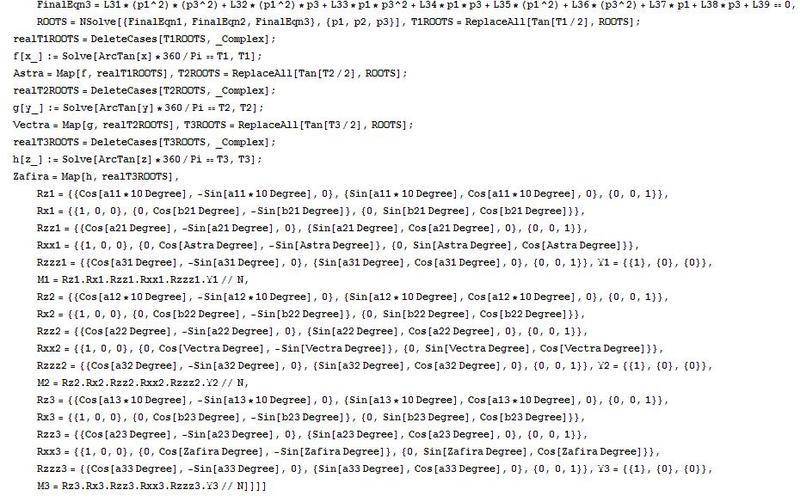

Solve[ArcTan[#]*360/Pi==T1, T1]& /@ DeleteCases[Tan[T1/2]/.ROOTS, _Complex]
OR exactly the same thing written in a different way
T1ROOTS = ReplaceAll[Tan[T1/2], ROOTS];
realT1ROOTS = DeleteCases[T1ROOTS, _Complex];
f[x_] := Solve[ArcTan[x]*360/Pi == T1, T1];
Map[f, realT1ROOTS]
Then repeat this for T2 and for T3

Last thing that I need is that I would like to put each T1, T2 and T3 into some matries and result it. I tried this, but I could not. pls help about this.
I mean that these result are put into matries algebra which will result in some cordinates in x-y-z,
I uploaded what I tried.
Thanks already

Rxx1 = {{1,0,0}, {0,Cos[#1 Degree],-Sin[#2 Degree]}, {0,Sin[#3 Degree],
Cos[#4 Degree]}}& @@ Map[Last[#] &, Flatten[Astra]];
Rxx2 = {{1,0,0}, {0,Cos[#1 Degree],-Sin[#2 Degree]}, {0,Sin[#3 Degree],
Cos[#4 Degree]}}& @@ Map[Last[#] &, Flatten[Vectra]];
Rxx3 = {{1,0,0}, {0,Cos[#1 Degree], -Sin[#2 Degree]}, {0,Sin[#3 Degree],
Cos[#4 Degree]}}& @@ Map[Last[#] &, Flatten[Zafira]];

I would like to have a suggest from you about the points (x,y,z) found by matries algebra in the last step, I mean how I ought to put the points into 3-D, namely; the plotting ought to look very very nice:) maybe it is plooted in 2-D.
What do you suggest me?

my screen result is below.
