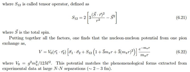

  • Would it make sense to average OPEP over all directions to ignore the angle dependence and hence get a spin-dependent spherically symmetric potential? If yes, how?
Here's what OPEP looks like (source: https://www.physics.umd.edu/courses/Phys741/xji/chapter6.pdf):

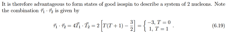

If I've understood correctly, the dot product of the two spin matrices is either 1 (for a triplet spin) or -3 (for a singlet spin). Earlier in the same paper we also see this:
... so I can also understand what the product thing with the taus is! I'm still not confident that I understand isospin though, so let me just confirm a few things: the deuteron can have either T = 0 or T = 1, but diproton and dineutron can only have T = 1, right? Is that the way it works?
And the deuteron bound state is with T = 0 and S = 1, so that (τ1.τ2) = -3, and (σ1.σ2) = 1, right?
  • Can I just set the tensor part of OPEP to zero?
In Krane's book Introductory Nuclear Physics on page 112 there is a very similar equation given for OPEP. The only difference as far as I can tell is that the version I presented earlier is in natural units... and Krane's version does not have the tau dot product thing (I have no idea why that is btw). Anyhow, earlier on page 102 of Krane's book it says that the tensor thing S12 "averages to zero over all angles", so I tried setting the term to zero, assuming I'd get the average part of OPEP out the other end... but it resulted in nothing but nonsense, because it makes OPEP positive for the triplet state and negative for the singlet state. Am I missing something or is the whole idea of setting the tensor part to zero stupid?
Also, setting S12 to zero makes OPEP specifically depend on (τ1.τ2)*(σ1.σ2), which is more than dubious since it works out the same for the deuteron ground state (T = 0, S = 1) as for dineutron and diproton (T = 1, S = 0).
