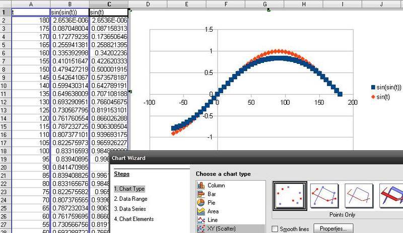

I still plan to graph x(t) = sin(sin(t)) in an Open Office spreadsheet to get a better grasp on the shape of the graph.
Sin(sin(z)) looks like sin(z) but with a more leveled off peak maxing at 0.82 instead of 1.0, at least for z under 180 degrees. Under 40 degrees, the two look extremely similar. Sin can probably replace sin(sin) in my calculations at lower values.
Hmmm...
I don't believe that spreadsheet. At 90 degrees, sin(90) = 1, and sin(1) = a bit over zero. Yet it shows it at 0.82.
The spreadsheet uses radians. I thought I corrected for them by using b1 = sin(sin(3.14*a1/180)). I now realize I should have done b1 = sin(180*(sin(3.14*a1/180))/3.14).
I seem to be making errors converting between radians and degrees. Maybe I should just do the x-axis in radians to start with, to keep it simple. I just graphed my above equation, and the result looked very high frequency. Not what I expected.
I just repeated the graphs, this time with the a column going from 3.1, 3.0, etc, to -1.6. Column B is sin(sin(a1)), and column c is sin(a1). I graphed it, and I got the same exact graph as the original above, but different scale.
I just don't understand it. Sin(90 degrees) = 1. Sin(1) = ... Oh. In radians, it is probably about 0.82.Well, I'm glad I'm working out these problems now, since I'm going back to school soon. I'm just amazed at the simple mistakes I'm making.So y= sin(sin(x)) looks very similar to y = sin(x) for all x, but is flatter and a bit lower in the peaks. Nice to know.

Also note that what you are plotting has θmax = 1, which is not a small amplitude.
