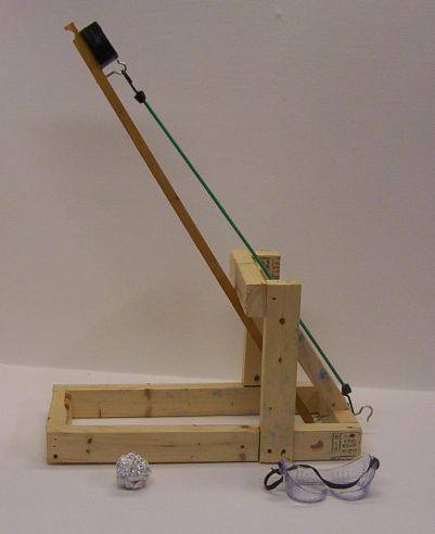

Im thinking of having a design like this with a spring or elastic band with adjustable mounting points to adjust for distance.
Im not sure if it would fit into the 15" cube though.
You can always scale it down to fit. Lack of lever-arm length can be compensated for by increased spring power.
