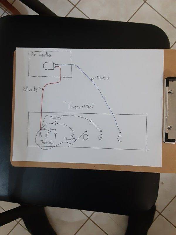

TL;DR Summary
There was 28 volts from R to Y. Why was there zero volts from C to Y?
The attached photograph contains a diagram that represents my understanding of how thermostats are wired internally. I recently did six experiments with the low voltage wires in the air handler of my heat pump. Here are the results:
Experiment 1# With the heat pump running in cool mode, R to Y was zero volts.
Experiment 2# With the heat pump running in cool mode, C to Y had 27 volts.
Experiment 3# With the heat pump running in cool mode, R to C had 27 volts.
Experiment 4# After the thermostat was satisfied, R to Y had 28 volts.
Experiment 5# After the thermostat was satisfied, C to Y had zero volts.
Experiment 6# After the thermostat was satisfied, R to C had 28 volts.
The contradiction I see here is between experiments #4 and #5. It might be the case that I see a contradiction because I am relying on a false premise of some sort. My understanding is that when the thermostat is satisfied, the switches are like the switches in the diagram in the attached photograph, with all the switches open. I know that when one reads voltage on each side of a wire across an open switch, one gets a voltage reading, not zero volts. I also know that when one reads voltage on each side of a wire across a closed switch, one gets zero volts because there is no potential difference between the two points. In experiment #4, the switch from R to Y was open. Therefore, I understand why there were 28 volts from R to Y. However, on experiment #5, C is receiving 24 volts from the transformer, and Y is not receiving any volts from the R side of the transformer. Therefore, on experiment #5, I would have expected there to be 24+ volts from C to Y since C is receiving 24 volts from transformer, and C is not connected to Y. On experiment #5, why was there zero voltage from C to Y?

P.S. I think I should mention that I don't know for a fact that my thermostat is wired up like I depicted my thermostat in the diagram in the attached photograph. That might be a false premise that I am relying on. The diagram in the attached photograph is just my understanding of how my thermostat is wired up.
This diagram looks incomplete to me. A thermostat has to have a temperature sensor somewhere, or at least something that opens and closes electrical contacts based on temperature. I don't see any such thing in your diagram. I also see a bunch of points just hanging in the air, which doesn't make sense.
I am assuming that the "bunch of points just hanging in the air" refers to the Y, W, O, and G terminals on the thermostat. I did not depict the wires going from the Y, W, O, and G terminals to the air handler and the outdoor unit in the interests of brevity and simplicity. Please just imagine that there are wires going from the Y, W, O, and G terminals to the air handler and to the outdoor unit. The imaginary wires going from the Y, W, O, and G terminals to the air handler and to the outdoor unit are irrelevant to the question of this thread.
Please just imagine that this thermostat has a thermistor for a temperature sensor. You can answer the question that is at the heart of this thread without these extraneous details.You can still answer the question of this thread.
How can you expect anyone to correctly analyze the behavior of a system if you leave out information?
Connections to the air handler and outdoor unit might be irrelevant, yes. But there's something you're leaving out that is clearly not irrelevant: where is the temperature sensor and what is it hooked up to?
Connected to what? A thermistor doesn't work by magic. It works by having electrical connections to other parts of the system. Where are they?
No, I can't, not with the information you have provided so far. And since you obviously can't answer it with the information given (since you posted it), I don't see how you can possibly believe you know what information is needed to answer the question, and that no other information is required. Wouldn't it be a lot easier to just assume that, if other people, who you are asking for help, are asking for more information, they might have some legitimate reason for doing so? Something like, oh, let's say, needing more information to answer the question?

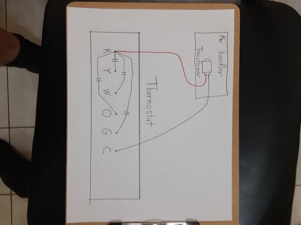

I am attaching a photograph to this post which has a diagram that shows how I would guess that the thermistor is wired up to the transformer.
The diagram in the above photograph is my supposition of how the temperature sensors in a thermostat are wired up to the thermostat. The thermistors in the diagram are the temperature sensors in the thermostat. The thermistors in the diagram act as temperature switches.
Ok, so it looks like the "switch" between R and Y would actually be a thermistor (which would make sense in the light of your #1 and #4). Is that consistent with what you see visually inside the thermostat? (A photo of the inside of the thermostat would be very helpful.)
Why do you think there would also be thermistors between R and W and R and O? (And why not between R and G?) Also, why are you labeling the line from C to the transformer as "neutral" and the one from R to the transformer as "24 volts"? Please note that I'm not saying you're wrong, I'm just trying to understand your reasoning, since you have the thermostat and transformer and air handler right there and I don't.

I don't have the thermostat in front of me to look. Besides, I am not really sure what the thermistor would look like exactly.
Because W is the heat strips, which are controlled by temperature. Now that I think about it, there would not be a thermistor between R and O. O would be controlled by a person pressing buttons on the thermostat.
G would be wired to come on whenever the heat strips are on and whenever the compressor is on. There would not be a need for a temperature sensor on G.
I started communication with a co-worker of mine who is an HVAC technician AFTER I made the OP of this thread. When I created this thread, I did not know that the C wire coming out of a transformer is neutral. Now that I know that the C wire coming out of a transformer is neutral, I don't think that there is a contradiction any more.
I learned today that the low voltage side of all transformers on residential heat pumps have one hot leg and one neutral leg. Everyone labels the R wire coming out of the transformer as the hot leg. The hot leg of the low voltage side of the transformer is 24 volts. The neutral leg coming out of the transformer is always labeled as C.
OK, so does this mean the OP question has been answered?
PeterDonis said:
Ok, good, this is all helpful information. Have you checked the voltages between R and O, G, or W under the different conditions?
No.
Yes. The (false) contradiction was that with the thermostat (stat) satisfied, there was 28 volts between R and Y, but there was zero volts between C and Y. When I first created the thread yesterday, I thought that with the stat satisfied, the voltage between R and Y should be the same as the voltage between C and Y. But that was all based on my false premise that R and C are both hot legs of power. Now I know that R is a hot leg, but C is neutral. Since C is neutral, it makes sense that with the stat satisfied, there is zero voltage between C and Y, even though there is 28 volts between R and Y.

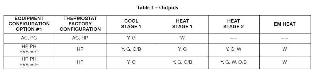

On the circuit board inside the thermostat, it says TC-NHP01 1311N049453.
I think it is the TC-NHP01-A thermostat.
https://www.carrier.com/residential/en/us/products/thermostats/non-wifi-thermostats/tc-nhp01-a/
sophiecentaur said:
Thanks for that. The documents make it clear what's supposed to happen. It just remains to confirm or disprove that it's doing the right thing.

The manual at your link does not say what the functionality of the switches is in the thermostat.
fourthindiana said:
Summary: There was 28 volts from R to Y. Why was there zero volts from C to Y?
'C' is common. 'Y' is cooling output.
In experiment #5 (thermostat satisfied), neither heating or cooling was commanded on.
No voltage would be expected between 'Y' cooling output and common because the cooling output relay within the thermostat would not be turned on.
One side of the 24V transformer secondary coil is connected to 'C' (common), and the other to 'R' (24V 'hot').
Supply voltage (nominally 24V) should always exist between 'C' and 'R'.
24V will be present at the 'W' (heating output), 'Y' (cooling output), and 'G' (fan output) whenever the thermostat's internal logic decides those functions ought to be on.
Table 1 from the manual shows which outputs ought to be on, depending on how it is configured.
@fourthindiana does that table help you? Your OP mentions inconsistency with what you expect but is there an actual fault?
