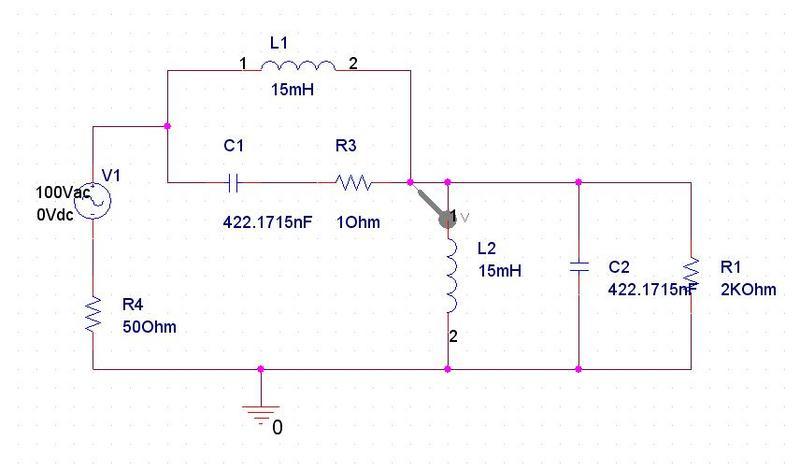

i need to find values of capacitors coils and resistors in order to create resonance mixed circuit on the frequency of 100 hrz (as shown in the following screenshot)
ω0=1/√(L*C)
ω0=2∏f0

as you can see from the screenshot, i built this circuit on the simulation program Orcad Pcspice and i try to find the values of the parts C,L,R in order to recive a resonance frequency in 100hrz,
my requirements are to build the circuit like this and to make the voltage 100v ac
i only know how to find those values on simple cascade/parralar circuits but not in circuits such as this one.
please give me the values and if possible show me how to find them
thank you :smile:

How did you determine what values of L,C and R to use for your simulation? Does this circuit not behave as you need it to?
Resistors have a relatively small effect on resonance frequency, so, as a start, you could try to get each pair of LC circuits resonant.
The other thing to note is that you can have any value of capacitor and still choose an inductor to resonate with it at any frequency.
So, to limit the choice a bit, you could pick a reactance (say 200 ohms) and calculate a capacitor and an inductor that both have this reactance at 100 Hz.
To do this, you need the formulae for reactance of capacitors and inductors.

ok i calculated this values by determin that the coil will be L=10mH
and calculated the Capacitor value to resonance frequency of 100 hrz
like this:
http://img593.imageshack.us/img593/8049/photo030212173055hdr.jpg
then i have only two values
L=10mH
c=253.302uF
i placed them twice in the simulation program Orcad Pcspice
(is this the right thing to do?)
http://img94.imageshack.us/img94/286/42599051.jpg
then i recived this
http://img580.imageshack.us/img580/8971/63874598.jpg
is there any way to recive this type of wave?
(maybe if i place a voltage probe in the coil and in the capacitor that shows me when the voltage is maximum in them?)
http://img823.imageshack.us/img823/5848/11132918.jpg
You haven't indicated exactly what you are supposed to be doing. You have constructed two parallel resonant circuits, and connected them in series. To investigate currents in L or C (with almost no effect on the circuit) you can insert a small current-sensing resistor in series with that element. You only need one L and one C to form the resonant circuit. You could insert a 10 Ohm resistor between an element and ground, and monitor the voltage across that resistor to see what the current in that element is doing. You don't need any other resistors, unless the lab notes say to add some.

and one more question, is it possible to get two resonance frequencys in one circuit such as this one?
Yes. But the result might not be as clear as you think it will be.
You can observe the current by placing a voltage probe on the top end of R4. In this case, a dip in current indicates a resonance.
If there is only one dip, then the two circuits are resonant at the same frequency.
You can deliberately move one of the resonances if you like. Just make the lower capacitor 400 uF. You will then get a double hump and you can see which is the sharpest. The lower frequency one is the tuned circuit with 400 uF in it.
What did you learn about the effect of resistors on tuned circuits?
Your reactances are about 6 ohms and this very low value will affect your resonance sharpness or Q.
