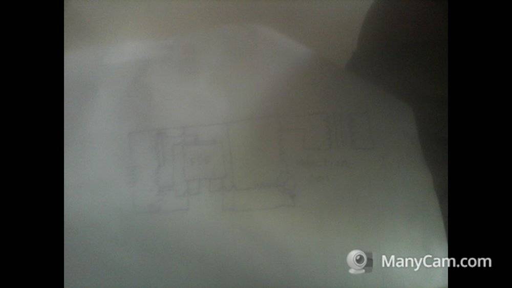

this is a schematic of the circuit
i posted a schematic. i am using dc current. now a answer my questions.
Take a look at your post. That schematic blur is unviewable.

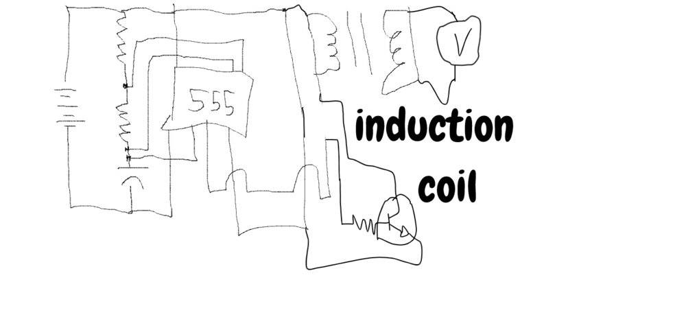

i think this schematic is more readable.
the capacitor has 120 microfarads.
the first resistor has 3000 ohms. the second resistor has 1000 ohms. the nail is approximately 9.5 centimeters
long. the diameter of the nail is approximately 4 millimeters. i think the secondary uses 28 gauge wire. i think the
primary is roughly half a millimeter. not sure what gauge that is. i use 3 18650 lithium ion cells to provide roughly 12.2 volts. i think i am using a dt850l digital multimeter.
You show your input and output coils shorted to themselves. If that's how it's wired, it's no wonder it isn't working. You need to be pulling down on the bottom of the primary coil with your transistor's collector, and the top of the primary coil needs to be connected to the postive power supply. Then the bottom of the output coil needs to be grounded, and the top of the output coil needs to go through a diode to a storage capacitor.
Like this:
Likes sysprog
the bottom of the primary coil is connect to the transistor's collector. the top of the primary coil is connected to the
positive power supply. so current flows out of the transistor's collector, through the primary coil, and into the
positive power supply. the secondary coil is not connected to the power supply. the secondary is connect to the
multimeter, but not the power supply.
Can you please update your schematic to make it accurately reflect what you just said? Thanks.
Likes sysprog
i think this reflects what i said accurately.
Okay, that's better, thanks. But you should still take out the lines that appear to be shorting the primary and secondary coils just to be more clear and standard for drawing schematics.
If you don't use a rectifying diode in the output and want to measure it with an AC measurement, you need to be sure that the AC measuring device can keep up with the switching frequency. Maybe start with a diode there anyway just to make it so that you can measure the output with your DMM on DC input mode.
With those changes, what do you measure for your output DC voltage?

  1. There is about 2 Amps flowing thru the transistor when it is On and you stated it was rated at 1 Amp.
    • Use Ohms Law to calculate the Collector current based on the battery voltage and the resistance in series with the collector; then select a resistor to limit the current to about 1/2 Amp.
  2. The transistor Emitter appears connected to the wrong place, or the 555 chip is wired wrong, or the schematic is wrong. Please correct and let us know.
  3. Please show on the schematic:
    • The 555 pin numbers (and their names if you can)
    • All parts values (transistor, resistors, capacitors, battery)
Since the transistors seem to be shorted, the batteries may be dead. Check their voltage, both when they are not connected to anything and when they are supplying the circuit.
The 555 is running at a frequency about 2.4Hz (2.4 pulses per second) which is much too slow for the small induction coil you are using. You are wasting at least 90% of the battery energy by converting it to heat in the 6 Ohm resistor and the coil.
I suggest changing the 120 microfarad capacitor to 5 microfarads. You won't be draining the batteries so fast, and it will get you a frequency about 58Hz, which would be within the AC measurement range of you meter. This can be changed later if you need a different frequency.

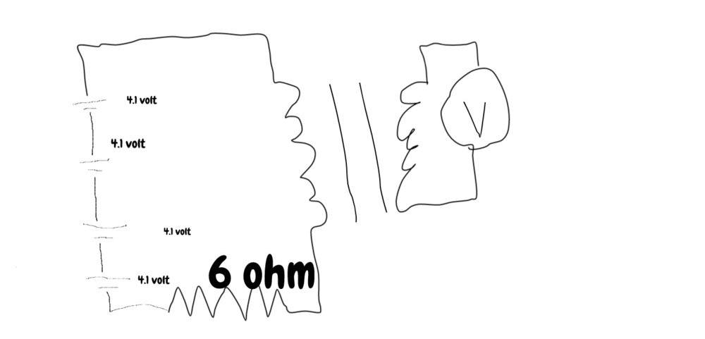

i taped wires to the 18650 lithium ion cells, connecting 4 lithium ion cells in series. the 6 ohm resistor was connected to 4 18650 lithium ion cells in series.
  • #31
It's still not obvious what you are doing here but it looks as if your short circuit current was Four times the 600mA I suggested, which means a 2.4A drain on your cells to start with. This may mean you have exceeded the 1C discharge rate (depending).
Taking the cells our of the box means that there is none of the protection that you get within the battery .
That suggests your contact may not be good and that you now have a high resistance contact with your wires. Did you try Solder?
Do you seriously have a problem supplying PF with a decent schematic diagram? If you are trying to self-educate then IT is a topic that you could benefit from.
  • #32
is this a proper schematic . i was alternately disconnecting and connecting wires.
  • #33
Much better thanks.

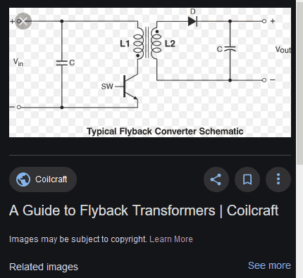

Did you ever look at designs for induction coil circuits? They include a Capacitor to increase the Primary pulse voltage due to resonance. You put the C across the opening contact gap.
  • #34
i tried looking for websites that explain how to design a induction coils. could you show me a schematic of an induction coil circuit.
  • #35
Another thing that could help your iT skills would be more practice with search engines. Asking PF is not the best way forward. Search with the terms in your last post and you should get somewhere. PF is not a spoon feeding service and I think this point has been made to you already.
