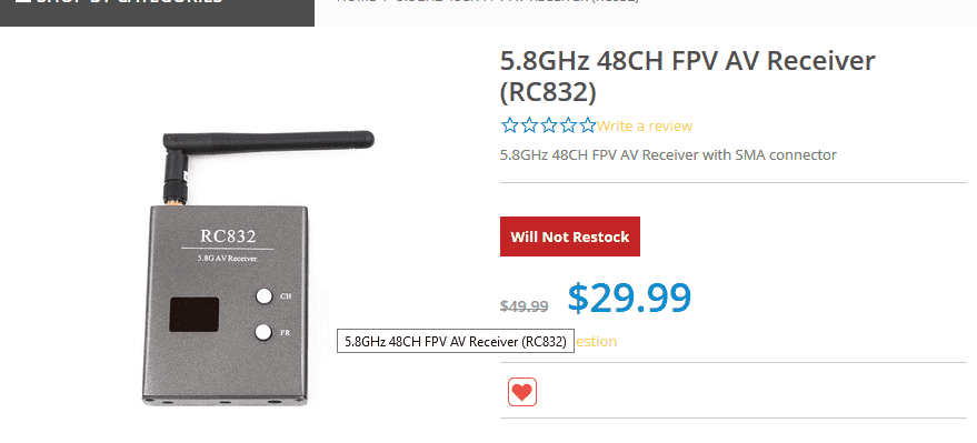

You mean RC832 ? With an antenna ? Why not use that ?

If you have a complete receiver for this link testing, why are you trying to make your own antenna?

because i am trying to get more range. an antenna picks up the radio signals from ts832 transmitter and sends the signal to a second antenna that will retransmit the signal at higher frequency to get longer range.
