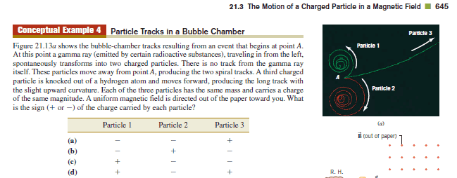

Figure 21.13a shows the bubble-chamber tracks resulting from an event that begins at point A.
At this point a gamma ray (emitted by certain radioactive substances), traveling in from the left,
spontaneously transforms into two charged particles. There is no track from the gamma ray
itself. These particles move away from point A, producing the two spiral tracks. A third charged
particle is knocked out of a hydrogen atom and moves forward, producing the long track with
the slight upward curvature. Each of the three particles has the same mass and carries a charge
of the same magnitude. A uniform magnetic field is directed out of the paper toward you. What
is the sign ( +or - ) of the charge carried by each particle?
According to the book the answer is B but i don't understand why,and how to apply the hand rule
no equations
i know i have to use the first right hand rule,and i know the thumb represents the velocity,the rest of the fingers the magnetic field and the force is perpendicular to the palm

The spirals for particles 1 and 3 are both counterclockwise, while the spiral for particle 2 is clockwise. These facts suggest that the charges are particles 1 and 3 would have the same sign, and the charge on particle 2 would have the opposite sign. This rules out choices a and c.
What does the right-hand rule say about things? That would help you figure out why b is the correct answer and d is not.
Likes Lopez
putting it that way makes sense now thanks,but i still don't understand how we can use the hand rule to get to that answer,couldn't we have determined that b was the answer with just that reasoning that particle 2 is the only one going clockwise so that is why is negative
I don't think the right-hand rule involves "velocity" specifically.
Remember, an electron traveling thataway equates to a current heading thisaway. ;)
Do you know the expression of he Lorentz force, the force exerted by a magnetic field on a moving particle (F=q vxB)?
You know the direction of the initial velocity of all particles. The magnetic field is perpendicular to the paper and directed toward you. What is the direction of the force if the particle is positive, and what is the direction if the particle is negative?
thanks guys it makes total sense now
