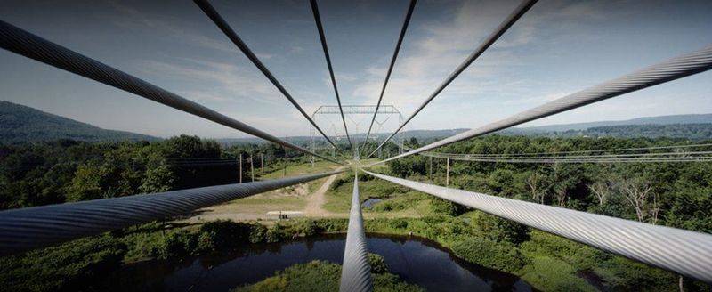

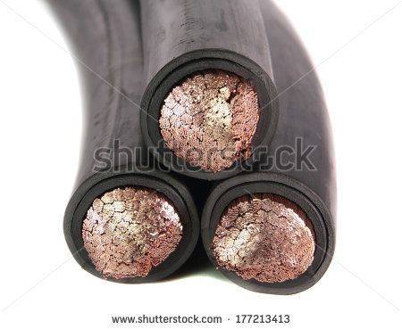

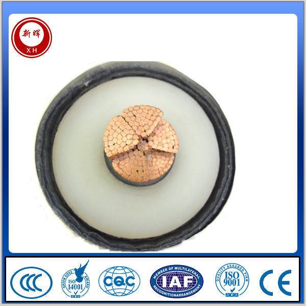

here's a few examples of HV AC stranded power cables ...
The top picture in post #7 shows a three phase Ultra High Voltage power transmission line, (maybe a megavolt). The nine near conductors in the image are all connected together as one phase, forming a cage. By using a cage the effective electrostatic diameter of the conductor is increased, which is done to reduce corona discharge from the wire. The current of one phase is shared amongst all nine conductors.
The forces due to wind on a suspended wire are significantly greater than forces due to gravity. A cage offers a lower cross-section to the wind than would a hollow tube, so the towers can be lighter and the voltage higher.
By using aluminium wires spun around a steel wire core, the tensile strength of the bundle can be greater and the weight less, so the towers with insulators for support can be further apart. Very little current flows in the steel core.
The two legged gantry in the distance, with the three shorter pylons, supports the three phases, each on three long chains of insulators.
So the 8 conductors arranged into a circle create one effective conductor. Is this voltage or current or frequency dependent?
There are 9 conductors in the example. This is simply a high voltage effect. The air is ionised near tight radii which results in corona discharge.
