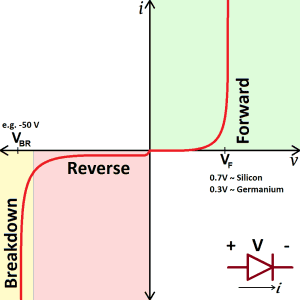

In all physics textbooks, the V-I graph for diode appears like the followings
http://211.233.39.205/phpBB2/forum_img/diode/diode-14.gif
However, when I conducted the experiment with a 1N4001 diode and 12V-AC, similar graph was found, the the graph seemed to have reflected along the y-axis.
sorry people, but I have no idea why it is this way. Since the x-axis should represent the voltage supplied.
What I'm thinking is that the x-axis is in the opposite direction on a C.R.O., which means more positive towards the left and more negative towards the right. Is that how a CRO works?
What's a CRO? We'll need some more information about your test setup how are you collecting and plotting your data. 1N4001 is a simple diode, there's nothing special about it.
CRO=Cathode Ray Oscilloscope
Sounds like he was trying to make a circuit to emulate a curve tracer with his oscilloscope.
Not to scale, this is what he should have seen...
http://forembed.com/project-curve-tracer-requirements.html
