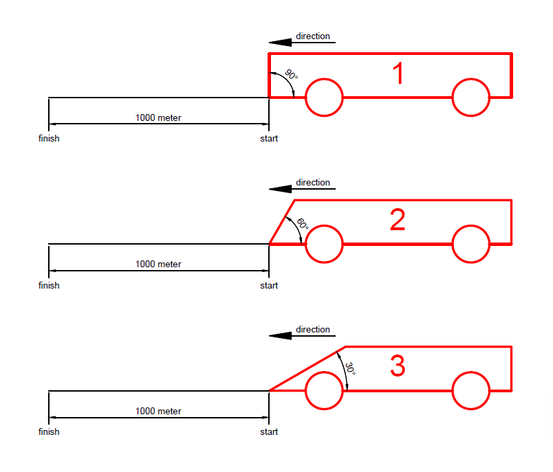

For example, there are three different cars, car 1, car 2, and car 3 (please see attached image).
The power of all cars are similar, 1000 HP.
The nose (front) of the car 1 is 90 deg, car 2 is 60 deg, and car 3 is 30 deg.
They all have to run a straight track with distance of 1000 meter.
I don't know, but if I take a look of the angle, the car 3 must be faster than car 2, and car 2 must be faster than car 1.
That's because (in my opinion) the nose (front) of the car 3 is sharper than car 2, and car 2 is sharper than car 1.
The question is, how do I calculate the drag, acceleration, and time to travel the 1000 meter straight track?

What level of schooling have you completed? This is something that is really difficult to calculate/model from scratch.

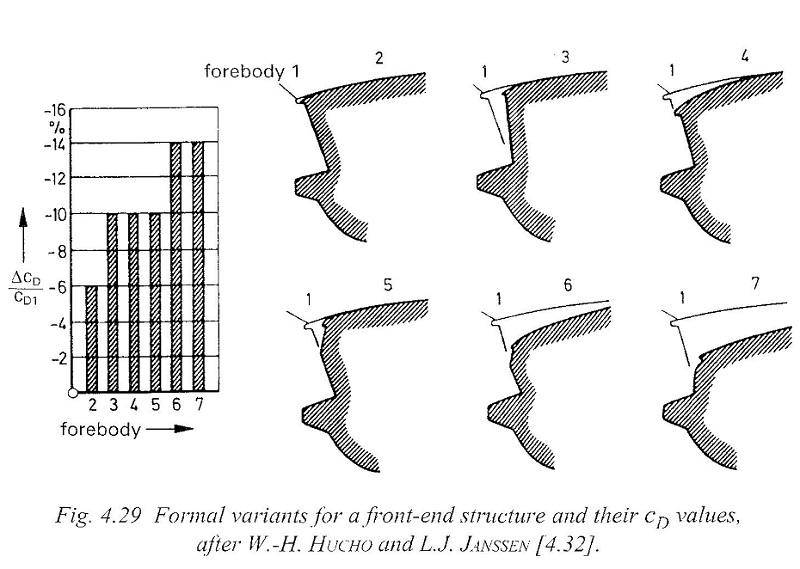

A good place to start for drag information is a copy of Aerodynamics of Road Vehicles by Hucho. The figure below is from the fourth edition page 156. There are many other figures showing various aspects of front end design on drag, downforce, crosswind sensitivity, and handling.
He also discusses the effect of aerodynamic drag on acceleration and top speed.

Because your question does not have a simple answer. That's the reality of aerodynamics.
