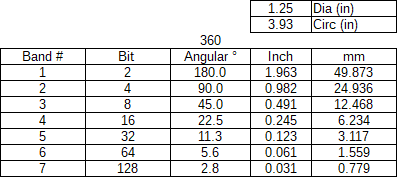

If DIY is preferable, and although I've not seen it done before, imagine instead of a code disc (borrowing the 4 bit binary example from their tutorial) it was a "code sleeve" that slid onto the shaft. This sleeve would consist of n number of bands each lined up with a phototransistor. I'm visualizing it similar to an old-fashion slot machine with each bit position being a separate reel.
246296
A quick look at 3D printers suggests they ought to be able to lay down clean lines at least as small as 0.75 mm. For a sleeve OD of 1.25 inches this is about how wide the lines are at the 7th bit position.
246297
At some point the lines will be so close together that a particular phototransistor design won't be able to sense the light/dark difference (and I don't know what that point may be; perhaps the 7th bit isn't practical), but all you need is 6 bits to get an angular resolution of 5.6°.
