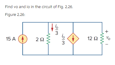

I with this circuit -- 2 resistors and 2 sources....
In summary, the problem involves finding the voltage and current in a circuit with two resistors in parallel. The initial equation shows that the sum of the currents in each branch is equal to the total current. However, the two images provided show different values for the current in the 2 Ohm resistor, which leads to different solutions. The correct problem is the one in color, and the equation for the voltage across the 2 Ohm resistor should be v0 = 2*i0/3.

15=[io/3]+[io/3]+ [vo/12]
I got this equation for the problem. Since the voltages of both resistors are in parallel, the both are equal. So for the first resistor from left to right... v1=[2/3]io but also v1=v0. So i replace vo with v1 in my equation, but i don't get the answers that i am suppose to get, which are 20V and 10 amps. It asks to find v0 and i0. I asked in other website and both said they did nkt get 20 or 10 neither. Help!

Did you notice that the two pictures you linked are different? The top picture has i0/3 in the 2 Ohm resistor and the bottom picture has i0. Which is the correct problem?

Oh sorry, the first problem from the top is the correct one. The one in color

Are you sure? The lower one is consistent with your 10Amp/20V answer. The upper one is not.

Yes i am sure, the one in color is the one that i have on my book. I already spent 3 4 hours on that problem because i can't get those answers so i am sure that's the one haha

Well, the answer to the one in color is most definitely not 10 A / 20 V.

Thank you. So is the equation that i got correct? Is vo also equal to 2io/12?

No. Since the 2 Ohm resistor and the 12 Ohm resistor are in parallel, they have the same potential (v0) across them. So if the 2 Ohm resistor has a potential of v0 across it, and a current of i0/3 is flowing through it, then by Ohm's law v0 = 2*i0/3. How did you get v0 = 2*i0/12?
I strongly suspect that the ##\frac{i_o}{3}## current label on the ##2 \;\Omega## resistor is a typo. Pretty sure it would make more sense if it was just ##i_o##.
