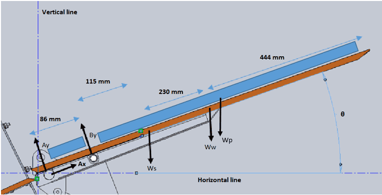

I am currently doing an internship and as part of my assignemnt I have to calculate the dynamic load on the bearing of a certain part that is rotating about a fixed point.
https://www.physicsforums.com/attachments/chute-png.103400/
This is the part that moves ( the brown part rotates about the back shaft)https://www.physicsforums.com/attachments/paint-chute-png.103401/ The Ww is 8 kg,
The Ws = 6 kg
the weight of the blue boxes (Wp) on it is total 50 kg and it is centerized
Tetha is 20-60 degrees
I would like to what the dynamic force load is
w = 0.5 rad/s
Sum of moments = Moment of inertia* angular acceleration
F= M*a
I assumed all the masses are combined to become 64 Kg acting at the center of the wood
but I got the force to be tiny.
I am lost on how to start [/B]

The system is rotating about which point, namely A or B?
Assuming the system is rotating about point A(as far as i understood) you can approach the problem in following way:
Calculate the spatial position of the centre of mass.
There will be several forces acting on this point.
The forces acting here will be: 1. Gravitational force due to the combined weight of the system acting downwards
2. Centrifugal force due to rotation acting along the line joining the point A and centre of mass of the system which will be mrw2
Resolve the forces along the direction of Ax and Ay.
There you have it.
Hope it helped

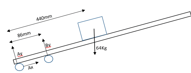

In order to simplify the question , I have made a new drawing.
About your point 1 : Don't you account for the reaction forces?
About your point 2 it's not clear which r I should take and do I then add the gravitational to the centrifugal force ?
How about the reaction forces ?

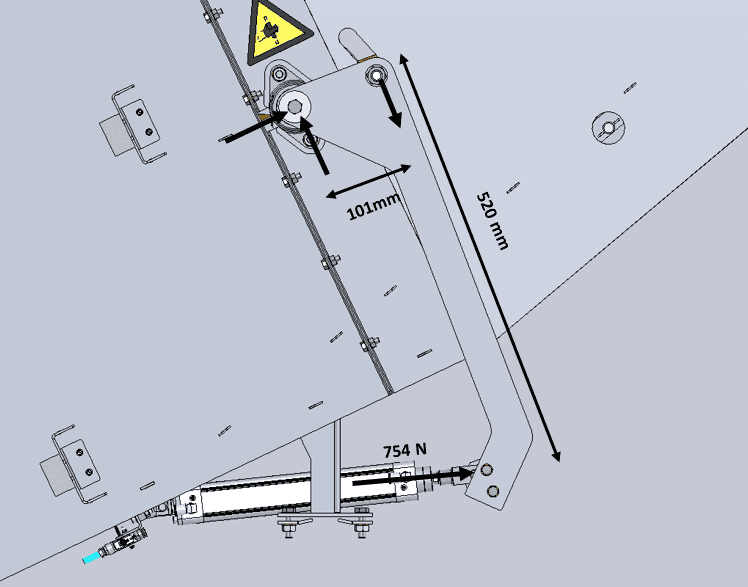

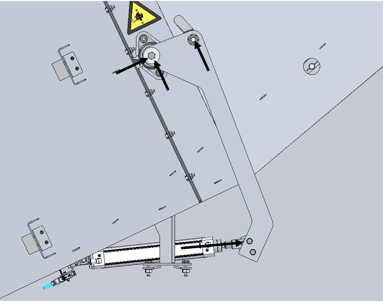

As you can see here , the arm is operated by a pneumatic cylinder.
The output of the cylinder is 754 N
The acceleration seems to be constant as the angle of cylinder change as the arm rotates about point A

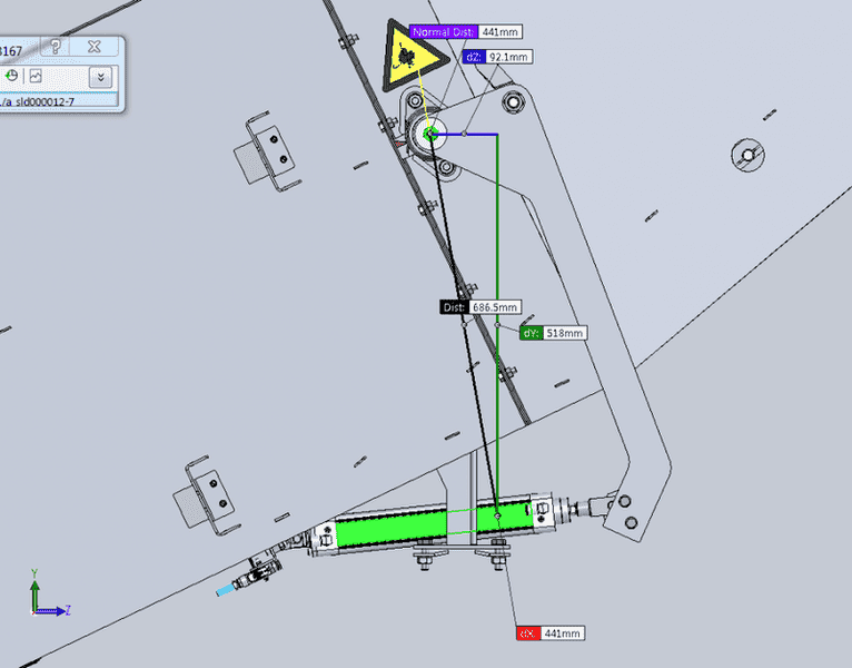

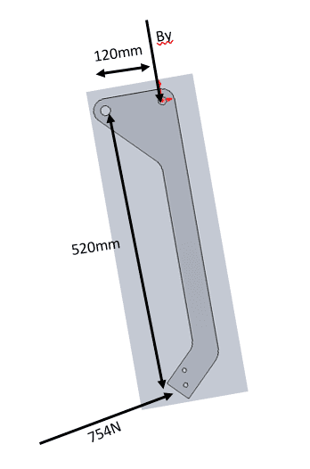

Excellent . We now have much better information available about the whole set up .
Here is some more information ,

You need to work out what effective force that cylinder applies to the platen lifting shaft .
(By in diagram in your first posting)
I did Sum of moments about A ( turning point) = 0
754 N*680 = By *110
By = 4661 N
Taking moments is correct method but one of the effective lever arm lengths that you have used may be wrong .
Show me a simple line diagram of the forces and lengths that you have used .
its the black distance , so it's okay it's right
Sorry , you are actually right ,
The distance is 529
so By = 3564 N
I haven't checked the actual numbers but that seems like a realistic figure .

So I took the part out with the forces in order to find the force B
Using moments about A I get
754 * 0.520 - By *0.12
By= 3267 NThen I used the diagram bellow
And I used the formula
Sum of moment = mr2 * angular accelration
Hence I get
3267*0.086 - 640cos 20 * 0.44 = mr^2*a
754 * 0.520 - 3267 *0.086 = 64 *0.44^2 * a
a= 1.27 rad/ sec and my tested value is approximately 0.7 rad/s2 so I think that this is a good estimate ?Since the angle of the pneumatic cylinder changes as the arm goes up then I assume the force supplied by cylinder is constant
But since the angle of the plate changes , the moment due to the weight will degrees hence results in a higher angular acceleration across time
  • #35
Yes, i think that's correct.
At the same time, the value of angular acceleration will change with θ(increase, since the cos component of the weight will decrease)
