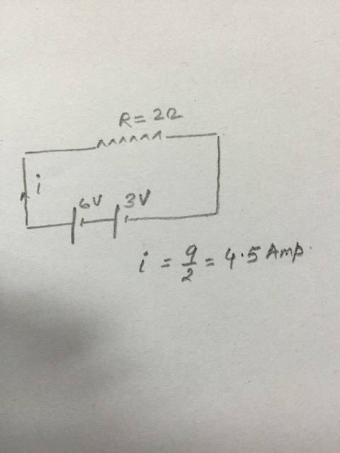

Is there any problem in this solution
No problem, since ideal voltage sources can go in series (and ideal current sources can go in parallel)
Ok ok got it
