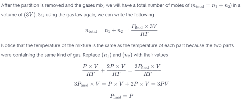

In the third last line of working, I do not understand why the pressure variable is changing? Shouldn't pressure remain constant and only the Volume change?
Where do you see anything changing ? Strictly speaking ##p_{\rm\, final} ## is unknown and to be determined.
Then the outcome is ##p_{\rm \, final} = p##
Comment: they use capital ##P## in the solution, which is undesirable: once lower case ##p## , always lower case ##p##
The 2 and 3 numbers are for V rather than for p.

Do you mean it is a typo/ error in the worked solution?
V + 2V = 3V
Likes Woopa
Lnewqban said:
V + 2V = 3V
Ah yes that make sense I can see now the numbers are actually for V, the way they've written out the equation has confused me.
