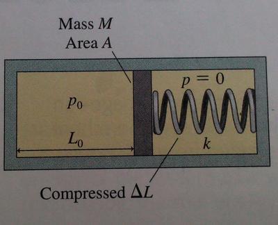

The closed cylinder of the figure has a tight-fitting but frictionless piston of mass M. the piston is in equilibrium when the left chamber has pressure p0 and length L0 while the spring on the right is compressed by ΔL.
a. What is ΔL in terms of p0, L0, A, M, and k?
b. Suppose the piston is moved a small distance x to the right. Find an expression for the net force on the piston. Assume all motions are slow enough for the gas to remain at the same temperature as its surroundings
c. If released, the piston will oscillate around the equilibrium position. Assuming x << L0 find an expression for the oscillation period T.

For part A, I don't think you need all the properties. For example the mass will probably be a component of part C but for part A just do a free body diagram on the mass. The mass isn't moving so the force from the gas = the force from the spring
That's what's so confusing to me that there's really not too much to say about the system when it's in that state! Yet a. is asking for... an equation by the sound of it. That seems to be impossible so I will assume you are right about that.
I might as well move on to b.
There is an equation. If you do a free body diagram on he mass M the force pushing to the right is P0*A. The force pushing on the mass by the spring is k*ΔL. Set them equal to each other because the forces are equal and solve for ΔL.
Part b the mass is moved to the right a very small distance x. This is where you use the ideal gas law but to=tf so Po*Vo=Pf*Vf
You know Po, V0 is lo*A, the new Vf is (Lo+x) * A solve for Pf. Force f is Pf*A
Part c. Since x is small this is simple harmonic motion for a spring
