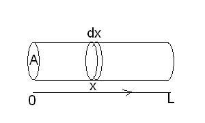

Given the temperature of an ideal gas in a tub where it varies linearly from (x=0) to (x=L)
T = To + [(TL - To)/L]x
where To is temperature at 0 length and TL is the temperature at the end of the tube
We are suppose to show that the equation of state for this ideal gas is
PV=nR[(TL-To)/ln(TL/To)]
As well as if then To = TL = T show that the equation of state reduces to the obvious one...PV=nRT

The problem is to find the equation of state of the ideal gas in that tube. That means the relation between P, V, he number of moles, and a quantity, you can call an effective temperature. The method is that you consider the tube as a couple of cells, each at the same pressure, and temperature as given at the position of the cell. You need to find the number of moles in each cell. For that, apply the ideal gas law PV=nRT for the cells. The number of moles in a volume element dV is equal to the density of moles multiplied by dV.
The density σ changes with temperature along the length of the tube, so you need a relation between temperature and density. σ=n/V. How is σ related to P and T?
ehild

You have the density at every x if you substitute T = To + [(TL - To)/L]x into σ= P/RT. From the density at x, you can calculate the number of moles in a small slice of the tube of volume dV=Adx: it is dn=σdV. If you integrate dn with respect to x from x=0 to x=L, you get the number of moles in the tube, which has the volume V=AL.
ehild

I do not like when an interesting thread is interrupted without any feedback, so I do a few steps steps forward; hopefully, I will be more clear now.
The molar density of gas at x is n/V=σ=P/(RT)
The temperature was given as T(x) = To + [(TL - To)/L]x. Introducing the notation
b=(TL/To - 1)/L,
T(x)=To(1+bx).
Substituting for T(x) in the expression for the density:
[itex]σ=\frac{P}{RTo}\frac{1}{1+bx}[/itex]
Taking a volume element as a slice of the tube with cross-section A and thickness dx, the number of moles in that volume is dn=σAdx. To get the number of moles in the tube, integrate dn with respect to x from 0 to L.
[tex]n=\frac{PA}{RTo} \int_0^L{\frac{1}{1+bx}dx}=\frac{PA}{bRTo} ln(1+bL)[/tex]
Replacing back b=(TL-To)/(ToL), and using that AL=V, the volume of the gas,
[tex]n=\frac{PALTo}{(TL-TO)RTo} ln(1+(TL-To)/To)=\frac{PV}{R}\frac{ln(TL/To)}{TL-To}[/tex].
From here, the equation of state is obtained in the form PV=nRTeff, where Teff is some effective temperature, characterising the gas in the tube.
ehild
