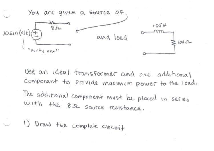

Hello everyone,
I understand that in order to provide maximum power to load, the load resistance (R_L) has to match the source resistance R_S. My main confusion is from the question itself on what my teacher meant by using "one additional component".
What I'm thinking is to change the load on the right circuit to frequency domain and add the two impedance. From there I would be able to add a impedance component on the left circuit to match the two, correct?
Can somebody possibly lead me to the right direction in this problem? Thank you :)[/B]
Your load has both resistance and reactance (an inductor) so the load is a complex impedance. The component you add to the primary will have to deal with matching the imaginary (reactive) part.
Take a look at the topic: "transformer impedance matching" or "transformer impedance reflection".
Hint: Start by choosing a transformer turns ratio to match the resistance in the source to that of the load.

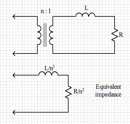

Okay, a couple of things. First, note that your 100 Ohms is now 28.3 rather than 8. This is because you forgot to square the turns ratio.
Second, the impedance of an inductor is a positive imaginary value: ZL = jωL. It's a capacitor that ends up with a negative imaginary value.
So, fix the sign of the inductor impedance and square the turns ratio and give it another go.

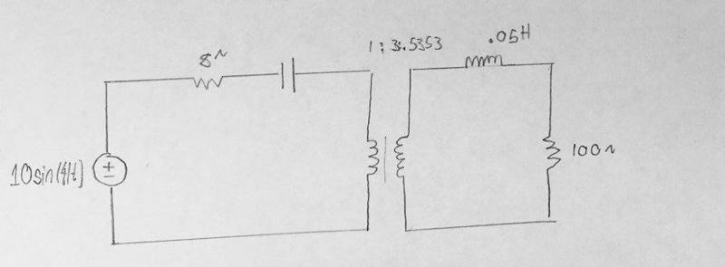

So the question that the problem wants is to draw the circuit. Would I have to draw it as an ideal transformer circuit with the core in the middle or equivalent circuit? :nb)
Aristotle said:
You're a great teacher thank you!
It sounds like they want a diagram showing all the components. That would be your original sketch with the transformer and capacitor inserted and labeled appropriately.
That's the part that makes me scratch my head..we are also adding 2 coils..or 2 inductors side by side to create this transformer circuit. Would these inductors need a value?
No, you need only specify the turns ratio.
I know I didn't label the capacitor value yet. But here is what I have so far in terms of drawing it :smile:
I'm assuming we can also assign dots and current directions if we wanted to, but that wasn't specify.Update my capacitor value is -.148 F
Aristotle said:
View attachment 96922 I know I didn't label the capacitor value yet. But here is what I have so far in terms of drawing it :smile:
You could, but it's not necessary. Your diagram looks fine (save for the missing capacitor value).
Note that the capacitance is positive quantity. It's the impedance of it that's negative.

Note that a real capacitor constructed from real materials cannot have a negative capacity. Take a look at the equation for the parallel plate capacitor: In order for the capacitance to be negative the permittivity of space εo would have to be negative; it's the only part of the expression that isn't a simple geometric quantity. Since εo is not negative, neither is the capacitance of a real capacitor.

I see..I appreciate the big picture. So the reason why you changed the imaginary part seen from primary to load to "-j.16400" is due to the maximum power theorem correct?
Right. The load inductance is reflected into the primary as inductance (positive impedance value). The negative impedance of the capacitor cancels it when they are added together (they are in series). So the voltage source "sees" a purely resistive load.

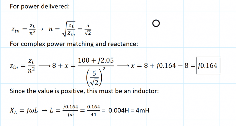

I
I must be missing something conceptually. How did you get this to a capacitor. This is what I tried
  • #34
Shenanigan_engineer said:
IView attachment 96947
Your first formula describes the impedance that the transformer presents to the rest of the primary circuit. Calculate that impedance without including the rest of the primary circuit.
Once you've done that you can consider the maximum power theorem for the new equivalent circuit in conjunction with the source voltage, its resistance, and whatever series device you choose to insert. Note that the equivalent impedance that the load presents to the primary is inductive. You choose a capacitor to add in series so that the maximum power transfer can be attained.
