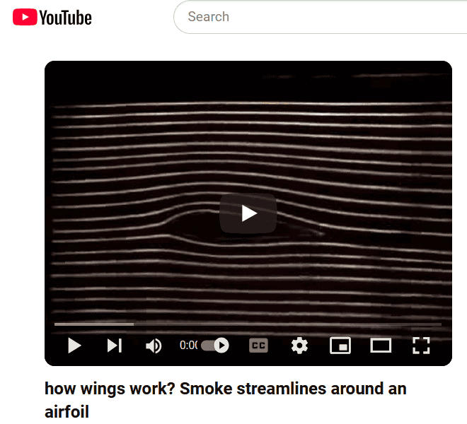

Does your tunnel have provision for moving streamlines around?
That's one thing I'd definitely like to explore more. I haven't used dry ice or a (glycerin) fog machine to get those kinds of laminar visuals before. I was worried about the glycerin fog crudding up the wind tunnel prop, and never really researched how those effects are otherwise created.

I am hereby seconding the smoke vis idea above. Using a fog machine or similar shouldn't cause you any problems. It's a very common technique in wind tunnels. Other flow visualization options should definitely be considered. It's one thing to measure forces and moments. It's another thing to connect the answers you get out of those measurements to flow phenomenology (like separation/stall).
Likes Klystron and berkeman
Could it be as simple as drilling some holes in a piece of PVC then feeding the fog through to get good lines? As long as the PVC is capped, the pressure should be the same at each hole.
Other option, since you have access to a 3d printer, is to make the smoke delivery as streamlined as possible to minimize disturbance. Might be a fun project/competition for the students, actually.
Likes mishima and berkeman
Thanks, that's a great idea, I'll have them investigating printer settings and print orientation to give the best streamlines. They can design different methods to attach the 'seeding rake' to the wind tunnel's inlet, and try different rake spacings.
