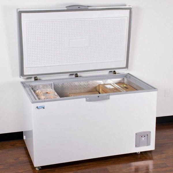

If anybody notices in supermarkets, etc, the frozen food are kept in glass-doored refrigerators. the prupose of the glass door is so the customers can see if the stuff they're looking is behind door number X, so, no opening door and got nothing, thus, increasing the temp in the compartment for nothing, where this would mean need to consume extra electricity to decrease the temp back to where it was for nothing.
now, the problem with this is that glass, even if it's not a good conductor, it still conducts heat. meaning, it heat from outside will still seep into the compartment, even when it's closed. I have 2 ideas:
1. in normal fridge in houses, we have 2 solid (non transparent) doors, top and bottom. I suggest we change this to a transparent material (glass, plastic, etc), but it a layered design. so the door is something like glass - vacuum - glass. the vacuum between glass is to prevent heat transfer from outside to inside compartment.
2. create more compartments in each section. so, right now, there are only 2 sections in a fridge --> freezer and refrigerator. normally, refrigerator section is quite big, so, I think it's better to further divide it to several compartment (tray level), so each tray is one separate compartment, so, when we open the compartment, we don't increase the temp for the other compartments.

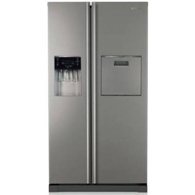

An idea i quite like is having a small access port in domestic fridge doors, just large enough to grab the milk or butter while avoiding the energy loss associated with opening the door.

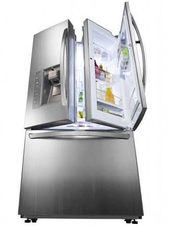

The door in door fridges are also an interesting idea;

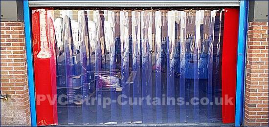

There are at least two simpler or less expensive ways I can think of to reduce energy losses when the refrigerator door is open.
They are both based on the principle that most of the energy loss comes when cold heavier air spills out onto the floor, and is replaced by warmer lighter air from above.
1) Make a horizontal refrigerator where the door opens from the top. That has a convenience cost.
2) Use a plastic strip curtain inside the refrigerator to slow down and reduce the spillage of cold air when the door is open.

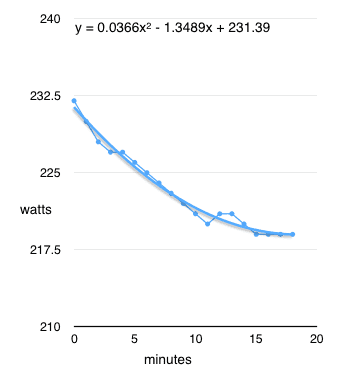

The first thing one should probably do is attach an amp meter to the fridge power cable, and see how much additional power is consumed after a normal access to the fridge. Alternatively, you could measure the temperature inside the fridge, and see how long it takes to go back to operating temperature.

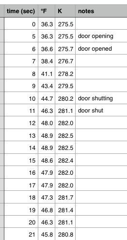

According to my calculations, I would have to open and shut my refrigerator door 36 times before it would cost me a penny's worth of electricity.
Based on:
the volume of my fridge: 0.37 m^3
difference in air temperature: 17.8K
my last electric bill: $0.122/kwh
and all those universal constants​
Although saving energy is always a good idea, I like to do a tad bit of maths before I invest too much money in things that will save me virtually nothing.

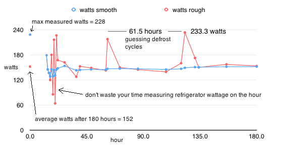

This sounds like a very good experiment. I purchased a Kill-A-Watt meter last summer. I think it will pay for itself in what it's made me aware of.
My above calculations were based solely on the heat capacity of air. Heat losses, I am sure, are higher, due to both convective and radiant energy transfers. Though, I doubt they will be significant. But, you can never be sure. The experiment has started.
And right off the bat, I notice a problem. My refrigerator has a power factor of 0.5
Volts: 121.4
Volt Amps: 413
Watts: 208
PF: 0.50​
I may have to look into this. Although I may not pay for un-utilized current flow, I have a feeling it makes the entire grid less efficient, which I would imagine we are all paying for.

  • see through fridge door --> already a concept by samsung (pretty sure it's not on sale yet, or is it?). the reason I brought this point up is that I've observed the behavior of normal people when opening the fridge :

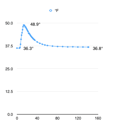

Preliminary results are inconclusive:
I either opened my refrigerator door 356 times last night, or
I have not collected enough data, or
I have not accounted for all significant variables​
Thank you for mentioning humidity. As everyone knows, warm humid air will condense on everything in the refrigerator. This may be significant. I will attempt to ascertain the humidity in my house.

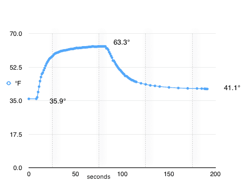

Mostly, I've been trying to not open my refrigerator at all. It is more difficult than one would expect.
So far, I've accidentally opened the door 4 times, and 4 times on purpose, for a total door open time of 30 seconds.
I've now collected 48 hours worth of data, and have come to no conclusions. I will probably do some more tests tomorrow.
Things I originally overlooked:
The unit is a frost free type, so it must have a defrost cycle. I have not determined how much power that consumes.
I have a feeling that when I'm done, I will have discovered that this is more of a psychology test, than a science experiment.

refrigerator with windows
refrigerator with drawers
refrigerator with the most doors
refrigerator with doors in their doors​
From personal experience, a water and ice dispensing door would reduce my door opening activities by 90%. After I affix my "Are you just bored?" sign, of course.
DrClaude said:
I would be curious to know how much heat is lost in the first few instants of the door being opened. Is there a big difference with the door being opened 5 seconds vs 30 seconds?
I can do that. But the results won't be available for another 2 days.
One complicating factor with my refrigerator[1], along with it being very cyclic[2] is that instantaneous power consumption varies between 213 to 228 watts.
And there is that dreaded "defrost cycle", which according to wiki, should be consuming between 350 and 600 watts, for about 15 minutes, for an indeterminate number of times a day.
And that dreaded measurement at t=20.95 hours: Watts = 1.3 [??] Does that infernal light bulb in the refrigerator really go out? Or, is it a quantum light bulb, that is both on and off?
hmmmm... Ah ha![1] Hotpoint model CSX20EKC, mfg 10/88 (29 years old!). If anyone has a schematic, it would be greatly appreciated.
[2] Duty cycles, measured on the hour, vary from 28% to 100%.
hmmmm... Ah ha!
Refrigerator light bulb: 60 watts
Freezer light bulb: 45 watts
This may take me a few minutes to calculate. Everyone else is free to join in:
If OmCheeto opens his refrigerator door for 30 seconds, and stares thoughtlessly into the abyss, wishing he'd gone to the store yesterday, but instead sees just a half a loaf of bread, does the light bulb or the exchange of air consume/impart more energy?
th 291.5 K
tc 273.7 K
delta t 17.8 K
air 1,000 joules/(kg K)
air cap of fridge 0.3718 m^3 measured
air 1.225 kg/m^3
air 0.4555 kg
air 8,107 joules
conversion 3,600,000 joules/kwh
air 0.00225 kwh
electricity 0.122 $/kwh
air 0.000276 $
air 36.25 times air replaced to cost a penny
ps. see previous posts for more data
just google them like I did
will take me a few minutes
Likes DrClaude
OmCheeto said:
...solution
4.5
@OmCheeto , if the effect is slight, you'll need an accurate measurement, with cycles averaged out. Try this.
Measure the kwh/day with normal use over one or more days. Compare that with the kwh/day energy used when you are out of town and the door remains closed.
