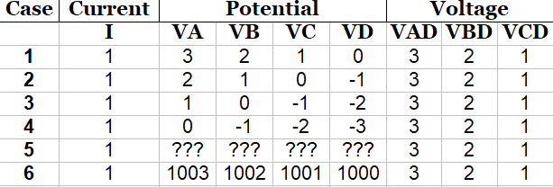

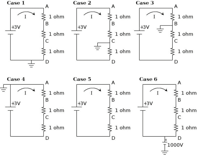

The way the OP is worded, it could mean two isolated open-circuit segments of wire with no current but different potentials. In those cases, there is no motion of the electrons due to potential. None. Zip. Compare those electrons with them motion of books on different levels of shelves in the library. Different gravitational potential, but no motion.
But if the question means potential of wires in a circuit, that gives me the excuse to repost one of my favorite examples.
