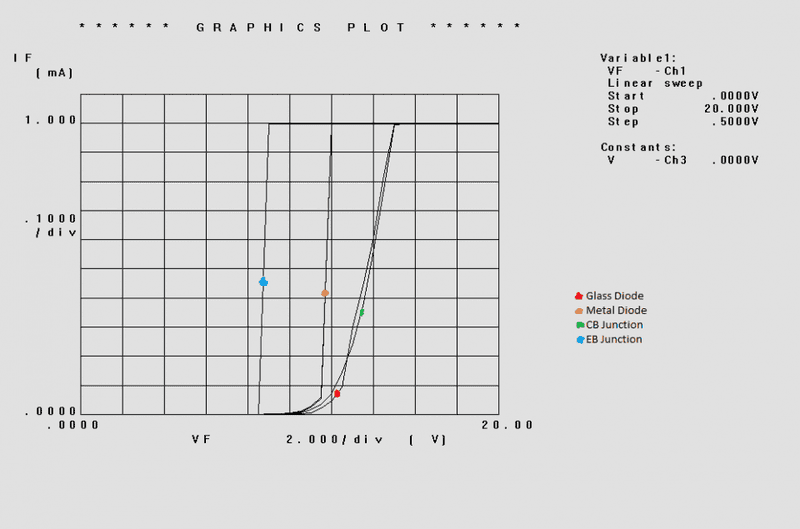

Hi everyone,
I'm looking for a metal diode that has a maximum reverse breakdown voltage of about 11.500 V and a turn on voltage of about 0.750 V.
Below is a plot of the reverse linear IV characteristic where the metal diode is marked by an orange dot.
Below that is a plot of the forward linear IV characteristic where the metal diode is again marked by an orange dot.
I suspect the metal diode is some type of 1NXXXX diode, but I am unsure what specific model it is.
I also remember the diode itself was small and grey with a black strip indicating the cathode.
If anyone might know what specific model this diode is, I would love to know.
Thank you.

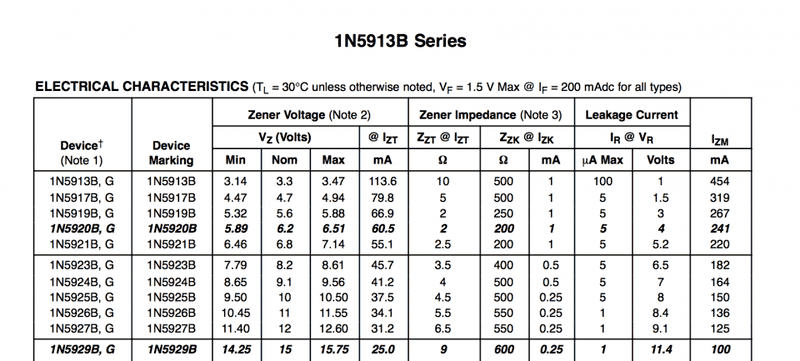

Disregard my last post. I think I found a better option:
The closest ##V_Z## would be the 1N5927B, G with a ##V_{Z_{min}} = 11.40 V##
Are you trying to identify it, or find a replacement ?
Datasheets give other clues besides electrical characteristics, and hints for use.
http://www.onsemi.com/pub_link/Collateral/1N5913B-D.PDF
if the one you tested has a metal case it's probably rated a watt or more
your 1N5927 is a 3 watt as you doubtless noted.
Be aware of importance of keeping the leads short on such a device that's going to be operated near its rated power
old jim

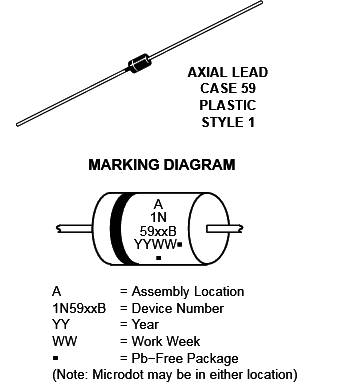

How about a photo of the original diode with dimensions. From that we can identify the package standard and then power rating.
A replacement zenner diode can then be selected from currently available parts.
