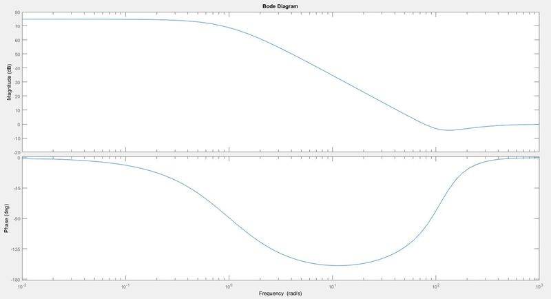

In summary, the bode plot shows the frequencies where the feedback is large, negative, positive, and negligible in a feedback system. The region of positive feedback occurs where the magnitude of return difference is less than 0 dB, while the region of negative feedback occurs where the magnitude of return difference is greater than 0 dB. The frequency for negligible feedback can be identified as where the magnitude of return difference is 1, which in this case is approximately w = 5.
asd1249jf
Below is the bode plot of return difference, 1+C(S)P(S) in a feedback system. Identify the frequencies where the feedback is large, negative, positive and negligible.
[tex]P(S) = \frac{100}{s^2+2s+1}[/tex]
[tex]C(S) = \frac{220(s+50)}{s+200}[/tex]
Bode Plot, Feedback
Is there a way of identifying the frequencies where the feedback is large, negative, positive and negligible just by looking at the bode plot?
So the positive feedback would be where we start gaining phase & magnitude, so it'd be approximately w = 10^2.
Negligible gives you a gain of 1, so the frequency would be w = 5. Is my reasoning right?
Also what characterizes a negative and large feedback?
For answering the question you should know the definitions for negative and positive feedback:
* Region of negative feedback: Magnitude of return difference >0 dB (Transfer function gain decreases due to feedback)
* Region of positive feedback: Magnitude of return difference < 0 dB (Transfer function gain increases due to feedback).
