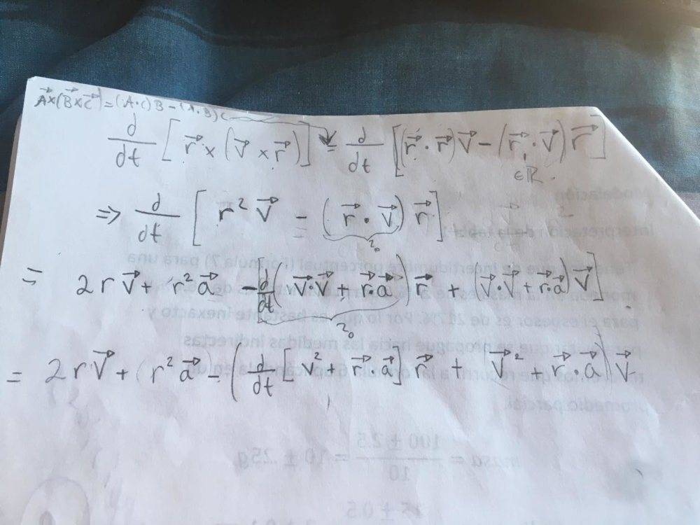

If r and v are both explicit functions of time, show that:
d/dt [r × (v × r)] = r´^2a + (r · v)v − (v^2 + r · a)r (All of them are vectors)
v=dr/dt a=dv/dt
any tip to start?
Expand the triple cross product. Look up the relevant identity for that and start taking derivatives.

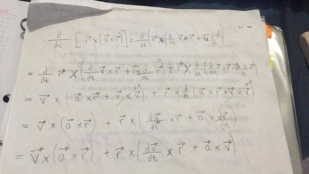

What happens when I've got the derivative of aceleration? and how can I plug in the dot product?? what did you mean when you say relevant identity?So far
It is not possible to get the time derivative of the acceleration when you take the first derivative of
r x (v x r).
Do some web research on "vector triple product". There is an identity that allows you write what you have in terms of scalar products. It's otherwise known as the BAC-CAB rule. That's what I mean by relevant identity.

so far, now it looks more like the expresion I want to get. But what can I do with (r· v)r. Have I done something wrong? At the end it should be (v2+r· a)r, instead of what I've got (v2+r· a)v
You need to check your differentiation of ##r^2 = \vec r \cdot \vec r##.
whats wrong? the derivative of r2 =2r+dr/dt
The derivative of r2 is 2r(dr/dt).

how can I differentiate d/dt ((v2+r⋅ a)r)? I did it as a product but that gets the derivative of aceleration and I don't feel its that way
Part of ##\dfrac{d}{dt} \left[ (\vec r \cdot \vec v)\vec r \right]## is ##(\vec r \cdot \vec a)\vec r##, There are no more derivatives with respect to time for this part. Why do you feel you need to take the derivative of the acceleration? I begin to suspect that you are unsure about how to take derivatives when you have a product.

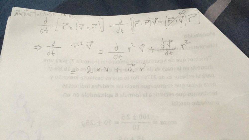

d/dt(r2v) its a product, isn't it? in that case, the derivative would be 2rv+r2a, wouldn't it??
and I referred to d/dt ((v2+r⋅ a)r), which I did it as a the derivative of a product and that's my biggest doubt. Did I do something wrong before?
Yes it would if you want to write that way, but it is not recommended for this problem. Anyway, if you choose to write this way and get 2rv+r2a, you are done taking derivatives of this part. Why are asking

Now my biggest doubt is: How can I derivate a dot product that's being multiplied by a vector?? take for example (r⋅ r)v
You apply the rule of multiplication as always: you distribute the time derivative operator,
$$\frac{d}{dt}[(\vec r \cdot \vec r)\vec v]=\left(\frac{d\vec r}{dt} \cdot \vec r\right)\vec v+ \left(\vec r \cdot \frac{d\vec r}{dt}\right)\vec v+(\vec r \cdot \vec r)\dfrac{d \vec v}{dt}.$$
