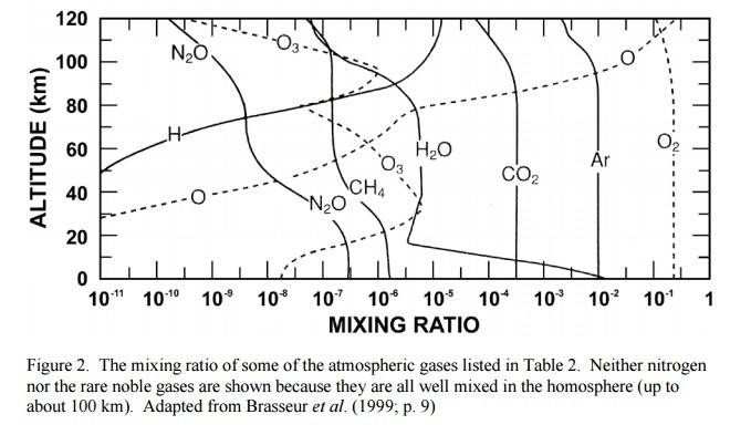

See: http://wordpress.mrreid.org/2014/08/01/the-composition-of-Earth's-atmosphere-with-elevation/
Now, virtually all of the variation is above 100km, which makes that hard to read, so I'd like to find some more detail of what those minor gases are doing down low.

Have a look at the link I posted. The graph shows the concentrations of [molecular] oxygen and nitrogen basically constant up to 100km, but gases with much different molecular weights like H and O (monoatomic?) vary noticeably...though those don't exist at the surface.
All that said, I'm no longer certain of the mechanism of the variation. I've only skimmed the theory, but what I saw implies that the variation above 100 km can be entirely explained by Dalton's law and the different molecular weights, not by buoyancy:
Each constituent has a density vs altitude curve who's slope depends on molecular weight: heavy gases weigh themselves down and light ones spread themselves out.

Gases like atomic H and atomic O are in very low abundance because they are created and destroyed by very rapid photochemical reactions. So they can't be regarded on the same basis as inert tracer gases.
Sure, below 100km it would be safe to say that O2 and N2 dominate and several others vary greatly or are limited due to chemical/thermodynamic processes (water, Ozone too).
Above 100km, it turns out that monoatomic oxygen dominates for a few hundred km, then monoatomic helium. This may be beyond the scope of the OP, but it fascinates me!
