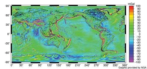

That's not true, either. Knowing how Earth's gravity varies with latitude and longitude is very important if you want to, for example, accurately predict the motion of a satellite or find a new oil field.
The above plot shows the difference between Earth gravity and that from a simple ellipsoidal model of the Earth. A Gal, or galileo, is 1 cm/s2. An mGal is 0.001 cm/s2. Note that the variations in this plot (plus or minus 100 mGal) are small compared to 1 g, 980.665 Gal.
The above is based on a very large (2160x2190) spherical harmonics model of Earth's gravity field, the Earth Gravity Model 2008 (EGM2008). See http://earth-info.nga.mil/GandG/wgs84/gravitymod/index.html.
While that's true, let's go back to the OP's question.
MissMath said:
is it true that if Earth's density wasn't uniform then the gravitational force was half of what it is now? can you give me a mathematical calculation of why that would reduce to half of its current value.thanks:smile:
We're not talking about the tiny non-uniformities that let one find oil fields, we're talking about factors of two. So while I probably should have had a couple of paragraphs of caveats, the approximation of the Earth as a sphere whose density depends only on radius is a pretty good one to answer the OP's question.
