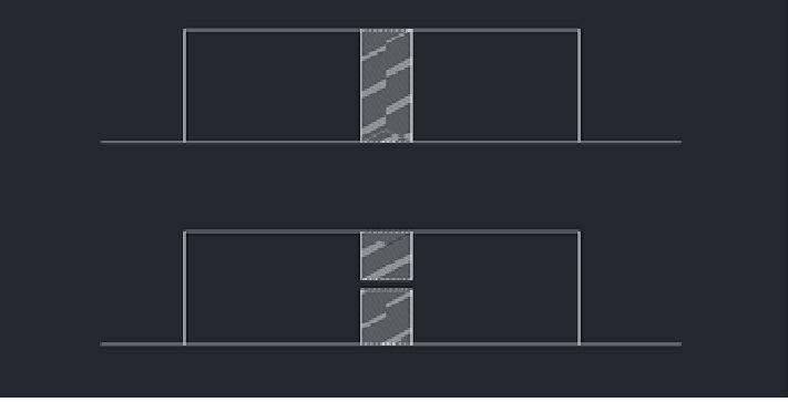

If gas volume remains constant, it can do work?
In summary, the conversation discusses a simple example of a system with two chambers separated by a membrane with a small hole. The gas in one chamber is at high pressure while the other is at low pressure. When the membrane is removed, the gas expands and does work on a cart with a sail attached. This process is not an isochoric process and can result in a change in temperature for real gases. However, for an ideal gas, there is no change in temperature or internal energy. The concept of work in this scenario is also discussed.
Let me guess - the amount of gas in the volume is not constant?
My English is not good, but I think I can describe it clear.
The boxes in figure are rigid. There is a membrane with mass dividing the box into two parts. The left part is filled with high pressure gas, and the right part is filled with low pressure gas (or vacuum). The only difference between the upper fig and the down fig is: there is a small hole in the membrane in the down fig. There is no friction between membrane and the box. Because there is a hole in the membrane, the gas in left part and the right part can be seen a whole gas. And the whole gas volume is constant. The high pressure gas in left part must push the membrane with mass to move. The membrane’s energy is from the gas’s work, but the volume is constant.
The total volume may be constant but the volumes of the two regions are not and I think they need to be considered separately. If you want to find where the energy comes from, to move the membrane, you could look at any temperature changes involved.
What he said :)
What you actually have there is two chambers - and it looks like gas can flow from one to the other. The volume occupied by the gas changes. Another way of looking at it is that the system is not in thermal equilibrium with itself - since it does not have the same pressure or temperature everywhere.
Whichever way you look at it - this is not an isochoric process so of course it is possible for it to do work.
http://en.wikipedia.org/wiki/Isochoric_process
It looks like the OP is describing a free expansion of a gas.
It doesn't matter if the gas expands by the ( massless ) membrane moving, or through the pinhole, it ends up as being the same thing. The chosen system consists of both volumes on either side of the membrane to simplify the calculation.
There is nothing on the other side, ie the vacuum, to provide a force against expansion, and so it happens quickly, and uncontrolled.
Membranes are usually considered massless. So thus no work is being done.
It happens quickly, with no time for heat to flow in or out.
Thus, no energy crosses the system boundary, the internal energy of the gas is constant, and thus so is temperature constant for the gas.
That is for an ideal gas.

Of course its not quasi-static. An expansion into a vacuum is not quasi-static.
The temperature of an ideal gas in this scenario does not change from state 1 to state 2, and therefor neither does the internal energy.
From the first law
ΔE = Q+W
In this case,
ΔU = Q+W, as no other forms of energy are crossing the boundary.
ΔU = 0, --> the temperatue did not change.
Q = 0
It follows that W = 0
...the difference of two energy states must do work to others.
To what work are you referring?
If you take as the system the overall box, then no work is done on the system. And, if the overall box is insulated, there is no heat entering or leaving. Therefore, from the first law (as 256bits points out), there is no change in total internal energy of the system U in going from the initial equilibrium state to the final equilibrium state.

Some notes:
The mass on the membrane only slightly modifies the statements the others have been making.
To show work in your diagram, you want to explicitly show the mass (draw a square with "m" in it where the mass is), and you want the movement to be "upwards" (against gravity) and not sideways: this is so the final state of the system is clearly different from the initial.
The small hole in the membrane is a minor technicality.
You could have started with a chamber divided into two volumes by a removable wall.
One side is very low pressure and the other has a much higher pressure.
On the low-pressure side there is a small cart with a sail attached.
Quickly remove the dividing wall - now the gas on the two sides can be considered part of a single system much better than the case where there is a small hole. As gas rushes from one side to the other - the cart gets pushed along: accelerated.
Thus the gas is doing work on the cart.
Is this how you are thinking?

As Simon has suggested, whether or not work is involved depends on the choice of the system (or subsystems). All choices must lead to the same result for the final solution to the problem, but some choices (such as selecting the constant volume box as the system) make solving the problem much easier than others.

Stirling engine. One side hot, one side cold, sliding piston. Total volume of system is geometrically constant. Work is performed.
Did you really think that, if the initial and final volumes of a system are the same, that is equivalent to a constant volume process in a rigid container?
Chet
  • #31
Chet
The Stirling engine is a rigid container. Geometry (volume) of the container remains constant for the process, initial, during, and final, even though the piston is reciprocating. Gas density is moved from end to end.
Hence, Yes. But not on a closed system.
  • #32
Nuke,
I think you understood the context of the OP's original question, and that he was referring to a closed system in which the volume of the system remains constant throughout the process. I also think you understand that in a stirling engine, the movement of the piston causes the volume of the closed system and the volume of the gas to change with time over each cycle. So the only thing I can conclude is either that you were trying to mislead and confuse the OP, or you were trying to show everyone how smart you think you are by bringing up this example that does not even match the context of the original question. But, it is not very smart to get into a game of words with a Mentor. I am issuing you some Warning points and am closing this thread to further responses. In the future, please use better judgement.
