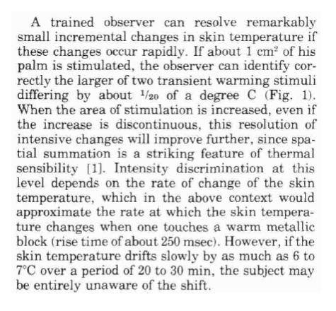

I think DrClaude's point is that we sense the speed at which it leaves, not the temperature itself (well, predominantly anyway... we actually have more than one kind of thermosensors and absolute temperature is detected to some degree). If you have a piece of metal and a rag that are the same temperature, the metal will feel colder than the cloth to a human because it conducts heat faster.
I could make a case for saying that the temperature at the interface between the object and your body (your skin) will be colder when it is contact with the metal than with the rag because of the difference in thermal properties of the metal and rag. The new information to me is that ones feeling of being cold depends more on the heat flux at the skin surface than on the skin temperature. Is this really correct? Literature reference?

Sure, and the relevant quote for convenience (no metadata so I hope an image will suffice):

There are actually two separate thermoreceptors: one for sensing cooling, one for sensing warming. Scholarpedia has an article that reviews the general literature:
http://www.scholarpedia.org/article/Thermal_touch

I am not familiar with all the terminology, but what I got out of these references is that our sense of skin hotness or coldness depends both on the actual skin temperature and on its time rate of change. Is this a correct interpretation?
Chet
More specifically, the relevant quote is "intensity discrimination [...] depends on the rate of change of temperature". The absolute temperature does factor in as a modulator, but the primary sensation is a direct relationship to the rate of change itself. Of course, we're limiting the discussion to feeling a fan in a room. When you are an extreme temperatures, the signal is more prominent (because of the danger, we might argue from evolution) as another set of receptors are activated, but it's still cooling and warming that acts on the sensing mechanism of the receptors, the absolute temperature plays more of a role in inactivating and inactivating the different receptor groups:
Scholarpedia said:
Although the thresholds for activating heat and cold-sensitive nociceptors are usually described as being greater than 45 °C and less than 15°C, in some individuals mild cooling (25-31 °C) and warming (34-40 °C) of the skin can evoke sensations of burning and stinging as well as innocuous sensations of cold and warmth
