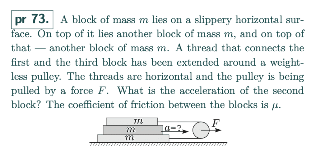

If I pull a pulley, what is the tension in the string around it?
The tension in the string around a massless pulley is F/2 due to the absence of net force acting on the pulley, which would otherwise lead to infinite acceleration. Each mass experiences a force of F/2 because the forces in the string branches must balance the applied force F. The forces acting on the pulley are equal and opposite, resulting in no rotation or movement. In ideal conditions with no friction, the tensions T1 and T2 in the string are equal, leading to the conclusion that T1 + T2 equals the applied force F. Understanding these principles clarifies the mechanics of pulleys in physics.

Please see the attached photo
F = ma
I assumed that each of the masses attached to the string would be pulled with a force F, instead of F/2, which appears to be the correct value. Why is it F/2? I suspect the fact that the pulley is "weightless" has something to do with the F/2 value. What is it?
Yes indeed. Since the pulley is massless, there cannot be a net force on it -- if there was, its acceleration would be infinite.

thanks for this. What is not clear to me is how the F/2 force in each branch of the string acts to negate the F force on the pulley. At the "bend" of the string, wouldn't the forces there just be F/2 in 2 opposite directions, both of which are perpendicular to the direction of F on the pulley? How does the pulley experience the opposing force of F?
Perhaps because I'm lazy, but I just imagine a "box" around the pulley with the two strings pulling one way and the force F pulling the other way. That way I can avoid worrying about the details of the interaction between the pulley and the string as it goes around the bend. (Note that there will be "normal" forces acting on the string as it bends around the pulley.)

Summation of forces and moments about the axis of that pulley are both zero, as the thing is not rotating or falling apart.
In order to be a balance of x-axis forces acting on the pulley, T1+T2=F.
For ideal conditions of no mass and no friction in the axis of the pulley, T1=T2.
