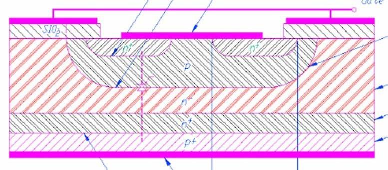

Could someone please illustrate the contrast among n, n+ and n-.
Density of n is higher in n+ region and lower in n- while medium in n region.
