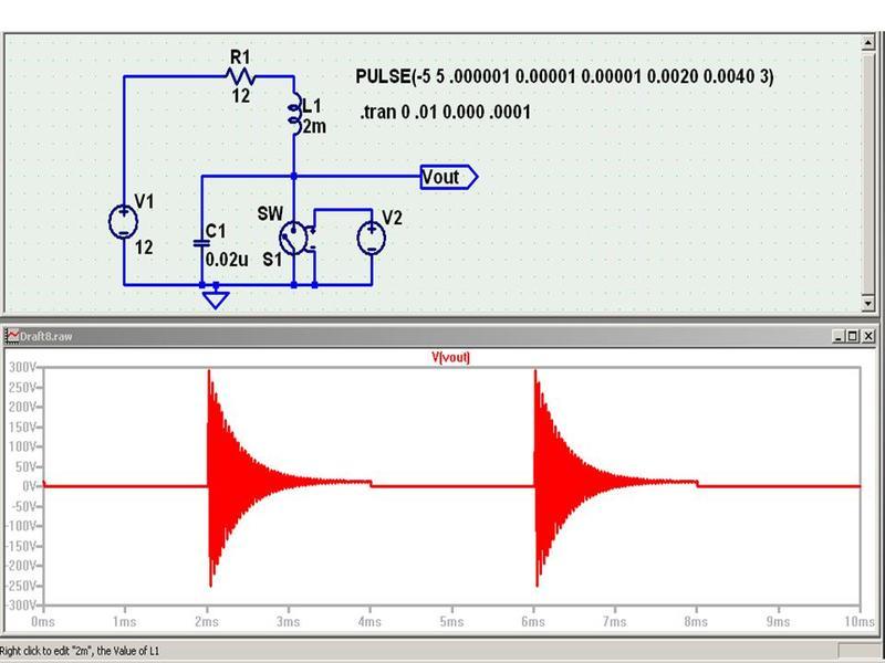

I saw a diagram on this Forum (by Bob S, I think) that showed the spark voltage as a positive then a slightly smaller negative then a slightly smaller positive waveform. This damped waveform went on for many cycles before it vanished.
I found it:
https://www.physicsforums.com/attachment.php?attachmentid=20126&d=1250393723

I totally agree with Bob_S waveform. But that one is what we have when we disconnect the secondary coil out of the circuit and leave the LC resonant circuit formed by a primary coil and the capacitor. (first ghraph)
But once we connect the HV coil with plugs and so on... the real wave form is that I have drawn (I have omitted some LC ripple).(second graph)

The discharge shown in my simulation was the primary side of the ignition coil; the secondary (high voltage) can have either polarity, depending on how the coil is hooked up. The RF waveform is a damped LC oscillator. As soon as a spark occurs, the stored energy in the LC waveform is quenched. In fact, some (many?) modern transistorized ignition circuits may have a series rectifier (or SCR) in the primary, which limits the waveform to one half-cycle. I looked at the schematic for the Mark Ten CD ignition circuit I have. The energy stored in the capacitor is dumped into the coil primary by a SCR triggered by the points (or by a Hall Effect sensor). As soon as the voltage on the SCR reverses, the SCR stops conducting and the spark stops.
Bob S
Bob S said:
...As soon as the voltage on the SCR reverses, the SCR stops conducting and the spark stops...
That would mean that the spark duration is about half the wavelenght of the LC resonant frequency.
As a normal spark durantion is between 1 and 2 milliseconds that means a resonant frequency of only 250 to 500 hz.
What do we do with the energy contained in the rest of oscillating cycles?
There something I do not understand, Bob S, Is it not the normal LC oscillating frequency in the range of 10 to 40 kilohertz ?.

You are right. I recall once measuring the natural resonant frequency of an ignition coil and "condenser", and determined it to be ~40 kHz. The "condenser" was 0.02 uF, so the coil must have been ~1 mH. At 40 kHz resonant frequency, a half cycle is ~12 microseconds. If a spark occurs on the first half cycle of the HV pulse, it will quench (discharge) any further HV, like you showed in your previous post #10.

Thanks Bob S. So it is the very first half cycle which causes the initial spark. Even more, depending on the dielectric characteristics this half cycle does not need to reach its maximum voltage to create the spark, because probably this only requires a percentage of that voltage to get established.
What I mean, even when that half cycle peak may reach -250 volts to produce a 25000 voltage at spark plug, the spark may jump with only 15000 volts, and in that case that primary half cycle voltage drops as soon as it reaches -150 volts.
Do you agree with this?
