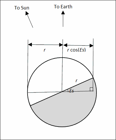

I understand your approximation for Es. What I don't understand is the expression of fi given in my first post. Why it is 0.5 * (1 + cos Es) ?

Sorry for the delay. This is best explained with a figure, and it was not until just now that I had time to make a decent one.
r is the radius of the moon, so of course the entire disk has a diameter of 2r. And, as the figure shows, the illuminated portion viewed from Earth is [itex]r + r \cos {E_s} = r(1 + \cos{E_s})[/itex]. So the illuminated fraction is their ratio,
[tex]\frac{r(1 + \cos{E_s})}{2r} = \frac{(1 + \cos{E_s})}{2}[/tex]
It's very clear ! Thanks a lot Redbelly98 !
