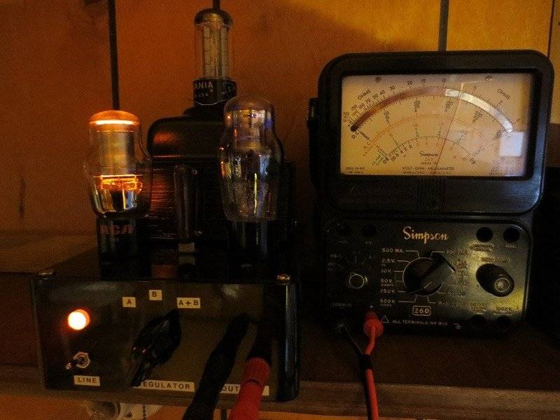

Maybe you could use it like a regulator tube in a power supply like the one I built. Also I've uploaded the GE Glow Tube application sheet.

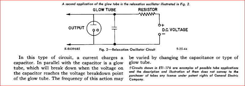

What a great find !
That thing just might stay lit at low enough current.
If not, perhaps make it into a relaxation oscillator at a few hundred hz, fast enough to appear continuous.
We used to do that ^^^^ with NE2's and a 90 volt B battery. I found that some resistance in series with the lamp prolonged its life.

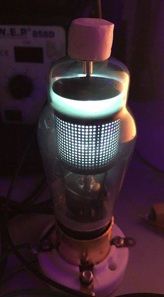

I did it!
Funny operation though. Sometimes it will stay on without the heating filament and sometimes not, even if the current is the same. I have it connected through 168VDC and a series resistor (~2k).
