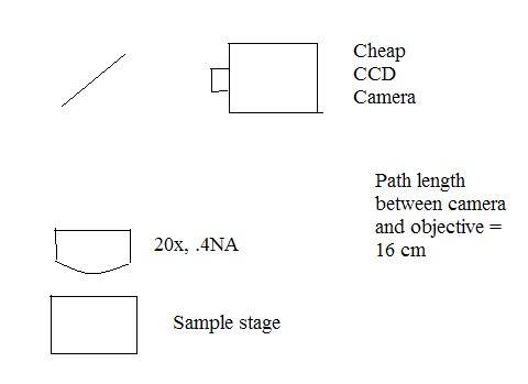

I am using a setup than involves an objective lens suspended over a microfluidic chip. A camera is positioned behind the the lens (well more precisely, the image actually reflects off a beam splitter into a camera, the beam splitter for the purpose of allowing optical tweezers to be used on the sample while simultaneously imaging on the camera).
The student who worked on this before me was able to see the erythrocytes just sitting there on a slide (and trap them with the laser), but in the chip they were nowhere to be found! I attempted the same and so far have also failed. What I probably want to do is maximize scattering/ minimize light hitting the camera that is from anything other than the cells (I suppose they call this dark field imaging?). I have not been successful in seeing anything after several days of messing around with the lighting (the light source is free to move basically anywhere). Some of my co-workers suggested lighting from above, or from the side, but still the only time I can even see the channel walls decently is when lighting from below ("below" meaning pointing at the front of the objective, through the chip). I have "frosted" the surface of the transparent fixture plastic that the chip sits on, again to maximize scattering. This improved the contrast of the chip walls a little bit, but I still see no erythrocytes. I have been able to see 6 micron plastic beads (which were supposed to represent the erythrocytes) but when I put the real thing in I see nothing. So now that I've ranted sufficiently, does anyone have any tips for lighting techniques for this sort of application?

Thanks for the responses. I guess I left out a lot of details. Here is a rough schematic:
The light source is a high intensity fiber illuminator (adjustable).
I'm not sure about the camera, it is just a cheap CCD camera. Through the camera is the only way of viewing the sample.
I can see erythrocytes in the sample solution when looking under a "real" microscope.
The channel is 100x100 um. I don't know the speed as I haven't actually seen them, but a slow flow rate of maybe ~100 um/s or so is what I am aiming for.

Oh my... I'm amazed you can anything to work at all with this.
First- the objective NA is really low for tweezing- are you trying to get a 3-D trap, or just hold the cells against the bottom surface?
Second- the path length you gave is really suggestive of a 160 mm finite-conjugate objective lens, as opposed to an infinity corrected objective. Either way, are there lenses on the camera? If you replace the camera with a sheet of paper, what do you see- an image plane?
Third- the main point- you have no illumination control at all. This is going to lead to all kinds of problems (flare is an obvious one).
I would start by looking at a target- get rid of the fluid chamber and put something down, anything, that has a known shape- print out (tiny) concentric circles on a piece of paper, or draw a small picture on a slide, if you have resolution targets sitting around (you can get some cheap reticles from Edmund Optics that can work). Looking at a known object will help you figure out what is wrong.
The flow speed is going to cause problems also- blurring. 100 um/s, even at 30 frames/s, will produce ~3.5 microns displacement during an exposure, which at 20X leads to about 6 or more pixels (depending on the camera).
The first step should be trying to image something simple, to get the optical performance optimized. Then start imaging your sample.
