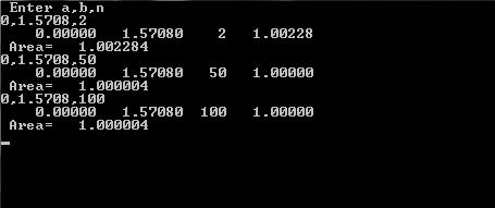

It worked. I had to also include a "go to" statement so that the *.exe file generated wouldn't close on me immediately after the solutions were output. I also added some "print" statements to simplify input and data recognition.
Good results too. Here were some results with varied number of intervals:
