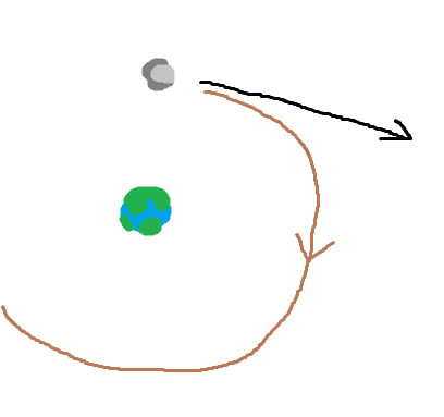

Now I'm not a rocket scientist, but I do suppose that after one hour, at 1km/s, our moon should have moved along the Y axis a bit more than 17.438km.
After around 7 days the moon should be at Y = 0, at 17.5km/h I doubt it will traverse 385000km
Our X position has moved a lot, however, and extrapolating this we'll see the moon move right indefinitely, whilst only going down a relatively small amount. Like this:
(Black arrow what it is currently doing and brown arrow what it should be doing. I also uploaded it as an attachment for future visitors should this image go down.)
I believe that my calculations are wrong. Or at least the vector implementation of said calculations. (I checked the gravitational acceleration at ground level and it was a steady 9.81m/s^2)
I was wondering if anyone could help me get on track with what I'm doing wrong, or what I should be doing instead. I'm also open to the possibility that my entire idea of how orbital physics should work is off, but if anyone could help me out then that would be greatly appreciated.
