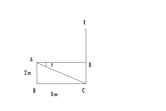

1) A man 2 meters tall stands 5 meters in front of a large vertical plane mirror. What is the angle subtended by his image in the mirror at his eye?
I solved it in the following way:
Let AB represent the man and CE represent the mirror mounted on the wall.Here I am assuming that the level of eyes and head are almost the same.
From the figure,
Tan(y) = 2/5
y = 0.38 radians
Is it right?

No, not right. Your error is treating the man's image as if it appears at the mirror's surface. But if the man stands 5 meters in front of the mirror, where is his image located?

The question is correct. While real images of real objects are inverted, not so for virtual objects. (To convince yourself of this, try drawing a ray diagram of a plane mirror with a virtual object. Is the image real or virtual? Inverted or not?)
