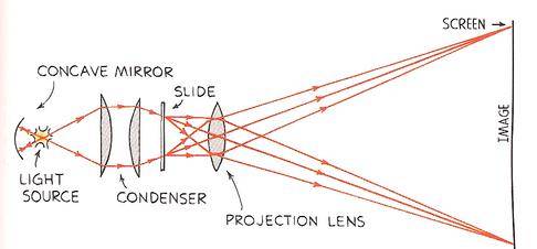

See the following image:
Notice that the light rays from the bottom of the slide are heading upwards. Once they hit the screen the rays reflect in all directions and the portion of the reflected light entering your eye head down (Just reverse the arrows and imagine that the projection lens is your eye). These rays then come to focus on your retina, with the rays from the top of the image being focused at the bottom of the retina and the rays from the bottom of the image being focused at the top (imagine the slide is your retina).
So the light from the bottom of the slide ends up being focused at the bottom of the retina and the light from the top of the slide is focused at the top of the retina. The slide is inserted upside down (according to sophiecentaur) so the image appears "normal" when viewed.
If you put your eye directly in the light path, the light rays exiting the projection lens don't reflect off of the screen first, so the rays from the bottom of the slide are focused at the top of the retina. In other words, the slide (or film, or whatever) appears the same orientation as it does when viewed without the lens but since it is loaded upside down it looks upside down.

Just to elaborate on Drakkith's post, there are two inversions going on here. First, the lens forms an inverted image of the slide on the screen. Since the slide is upside down, the image on the slide appears right side up. When viewing the paper, the eye actually forms an inverted image of it on the retina. That's how we normally view things, but our brain adjusts so things appear right side up to us. So the slide image projected on the paper appears right side up.
When looking directly into the lens, you're putting your eye in converging beams of light so that's why I asked if what the OP sees is in focus.

The well known diagram of a projector optics is correct, of course but it's made far too complicated because it includes the mechanism which maximises the illumination from the lamp. We basically have a single convex lens to do the imaging. The only relevant difference will be the use of a 'telephoto' arrangement to achieve a shorter projector lens for the wanted Focal Length. Refractor telescopes do not use this method because there is a price to pay in quality / money.

This answers the earlier question about my 'reasoning' applied to the problem. A projector is normally focussed not far from 'infinity' (around 20mm compared with '12 feet') and the film would normally be not far from the focal plane of the lens. He screws the lens in a bit - to less than the focal distance from the film and he then has a Magnifying Glass, with a virtual upright image.
Did you never look at the back of a plate camera, with the focussing screen in place? You poor deprived boy. :wink: My dad had a half frame Voighlander and I played for hours. (Was never allowed to use an actual plate exposure, though.) The image is inverted (same as in your eye - AAAArghhh!) so, to produce the same scene when projecting, you have to invert (fully) the slide / film / plate.
