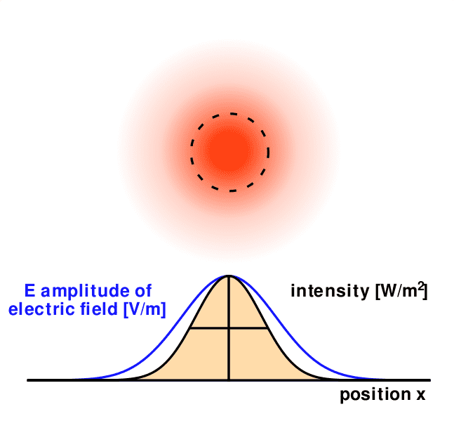

A laser beam would more normally have a more Gaussian distribution of energy, no?
https://commons.wikimedia.org/wiki/File:Laser_gaussian_profile.svg
