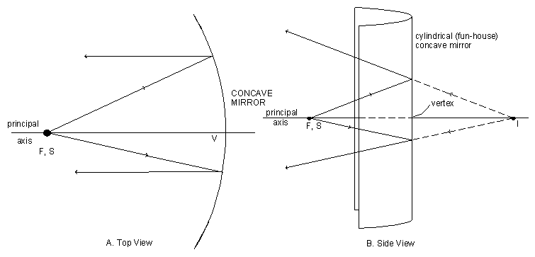

Here is my drawing of the concave cylindrical mirror. This isn't strictly accurate in the horizontal ("top view") as the cylindrical curvature in reality produces aberration for reflections occurring at the outside edges of the mirror, that is, when the aperture is significant relative to the radius of the cylinder.
S = point source of light (for example, 5 mm LED)
F = focal point
V = vertex
I = image

Simon Bridge I think is correct in his saying that what you would see is a line at a distance equal to the focal length, behind the mirror. The line should follow the curvature of the concavity of the mirror.
Taking the same construction as is used in spherical mirrors, the mirror equation tells you that an object in the focal plane will form an image at infinity. (I have posted a link about this already and it must be valid for a cylinder too; please read it and elsewhere) Ignoring spherical aberration, the image will cover the whole of the mirror and will be at infinity until the object is moved slightly away from that point. There is no defined image position for a cylinder because this is an extreme case of astigmatism when your eye lens has different curvature on two axes.
The xy component of this image will be a line (parallel to xy plane) but the cylindrical aberration will mean that its apparent position will not be at one depth. The image will, as I have pointed out previously, be in an undetermined place. Some of the image will be real and formed behind the observer and some of it will be virtual and in front. As soon as the object moves away (in or out) from the the focal point, the position of the image will be better resolved and your eye will 'grab hold of' the information that there is an extended spot with no defined place in the xy plane. Moving your head up and down will produce the parallax that you get in a plane mirror and your brain will tell you that the image you are seeing is distance f behind the mirror. But that is only one version of where the image is because the rays coming from the curved surface are coming from all directions; the image appears to be 'everywhere' (infinitely magnified) and, from the spherical case, it is at around infinity.
I repeat, however, that, due to the aberration, there is no fixed image position in an xy plane.
I have a Newtonian (reflecting) telescope and I can vouch for the fact that what I say is true. The exit pupil of the eyepiece is a small omni source (point), viewed via the secondary (but irrelevant) mirror. I can see that the main mirror appears to be uniformly illuminated by light entering the eyepiece; the image is spread out. The reflector is a paraboloid so the aberration is much less and I am looking at an image that appears at infinity (using the parallax method of moving my head from side to side).
PS the Mirror equation gives you different image positions, according to which plane you choose to cut through the cylinder with (any arbitrary angle) as you can get a not perfect but approximate variation of radius from r to infinity.

It's not as easy as that. As I said before, the position of the line in the z axis direction will be at f behind the mirror surface and this will be perceived by the parallax as you move your head parallel to the z axis. (Or with binocular vision when the eyes are parallel to the z axis).
However, the 'position' on the xy plane is totally indeterminate. It is 'everywhere' along a curved line. You can only say there is an image position if that image is in a single place. With a perfect point and cylinder, you will get a point at infinity behind you and then at infinity in front of you - as you move in and out from the focus.
You still seem to be asking for a definite answer to this one, for a situation that is indeterminate. Not all questions in Science have defined answers.
