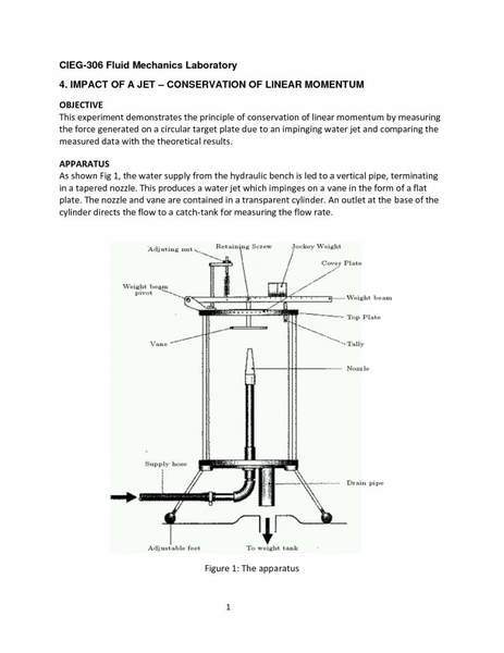

We recently did an experiment involving the impact of fluid jet on both plane and cupped surfaces. See the diagram attached for the experimental set up. We were asked to 1) verify the conservation of momentum and 2) calculate the discharge coefficient of the nozzle from which the jet emanates.
As you can sort of make out from the diagram below, a jockey mass was placed on a lever arm which was then balanced by the exerted force on the plate below due to the fluid jet. The Force exerted by the fluid can then be found by allowing the moment of the jet's force equal to the moment of the jockey masses weigh about the turning point. Then, you can prove the conservation of momentum by seeing if this value of F equals ##\rho Qv_1## where ##\rho## is the density of water, ##Q## the flow rate and ##v_1## the velocity of the jet leaving the nozzle. ##Q## was calculated an thus the value of ##v_1## could be calculated using the continuity equation and the area of the nozzle. This value was given and the distances from the turning point were measured for each jockey mass applied to balance the various different flow rates. Right so far?
My problem is that I have no clue how to calculate the value of ##C_D## for the nozzle. On our handout it says to use the equation ##C_D = C_V \times C_C## but I have absolutely no idea what ##C_V## and ##C_C## stand for let alone how to find them. Could somebody point me in the right direction?
##Q = Av##
##F_{Rx} = \rho Q(V_2cos\theta - V1)##
Sort of outlined what I've done above.
