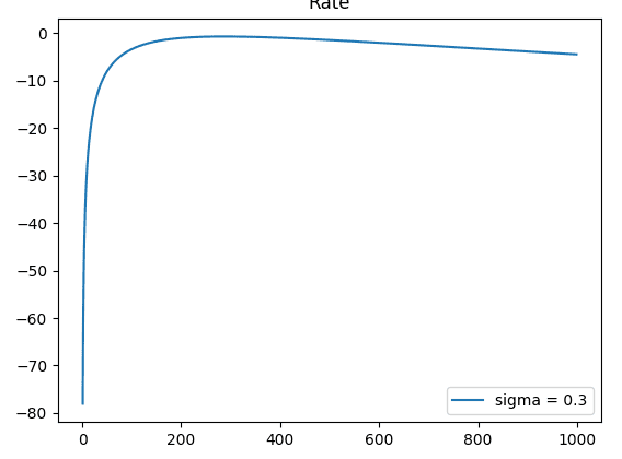

I have the calculation on secret key rate over the turbulence channel using Python code. The calculation is as below:

Theoretically, the SKR is low in high turbulence (sigma=0.9) and the SKR is high in low turbulence (sigma=0.3). However, after I ran this code, I get the wrong plot:
245757
245759
From the graphs, it can be seen at y-axis that the SKR under strong turbulence is higher compared to weak turbulence and vice versa. What is the problem in my calculation? Anyone, please help me. Thank you.

I have no idea about the underlying physics but the result fits to the code you wrote.
R is the same in both cases, let's focus on log_normal(x,sigma), especially the exponential function there:
exp(-(np.log(x/0.3)+(1/2*sigma*sigma))**2/(2*sigma*sigma))
Formatted:
$$\exp\left(\frac{-(\log(x/0.3)+1/2 \,\sigma^2)^2}{2\sigma^2}\right)$$
Your x range is from 1 to 1000, let's look at 300 for example: 300/0.3 = 1000, log(1000)=3. Plug it in and simplify a bit:
$$\exp\left(\frac{-(6+\sigma^2)^2}{8\sigma^2}\right)$$ As ##\sigma<1## we can neglect the right term and get approximately $$\exp\left(\frac{-36}{8\sigma^2}\right)$$
For small ##\sigma## the exponent is very large (here is a plot) and the expression is very small.

Thank you for your explanation. ;)
