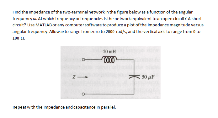

Z_L = jωL
Z_C = 1/(jωC) = -j/(ωC)
This is my attempt for the series combination:
Z = jωL + 1/(jωC)
Z = j0.02ω - j20000/ω
Is there a way to simplify this further? What would a graph look like, if the function has imaginary parts?
And also, to find the frequency for an equivalent open circuit, I would have to set the impedance to zero right? What would it be for a short circuit?
^EDIT: Actually I just realized that I would set Z equal to zero for a short circuit, not an open circuit.
For an open circuit, the impedance should be infinite, but how would I find the angular frequency?
∞ = j0.02ω - j20000/ω does not seem like a solvable equation.

Z_L = jωL
Z = jωL + 1/(jωC)
Z = j0.02ω - j20000/ω = j(0.02ω - 20000/ω)

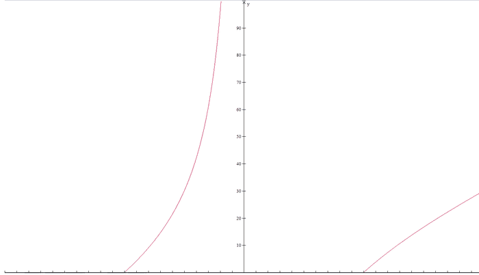

This is what I got for the graph of Z = (0.02ω - 20000/ω) (I am not sure how to use imaginary numbers in winplot):
Does this seem correct?
Also, to find the ω for a short circuit, I have to set Z equal to zero right?
For an open circuit, Z=∞, so how would I solve for ω in that case?

Your are asked to plot the impedance magnitude--that is the square root of the sum of the squares of the real and imaginary parts. You have no real part, so you just plot the absolute value of the impedance.
Also, no mention is made of the type of plot, but it's traditional to plot impedances on logarithmic vertical and horizontal scales. If you do this, your plot will look more like what you'll find in a textbook.
