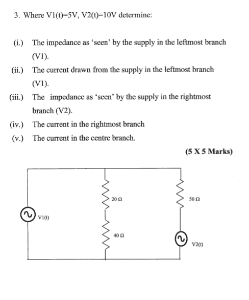

V=IR ?
My main problem with this question is that impedance seems to apply only when inductors and capacitors are involved, but this circuit includes only resistors, so it seems to me like I could just treat it as resistance in this case.
Any help would be appreciated. Thanks,
wheybags.

Yes, all of the impedances in this circuit are resistances.
Does that mean I can just treat it exactly like I would a DC circuit?
Yes. The AC voltage sources are shorted out for this analysis, just as you would do for a DC source.
No, impedance applies as well with R L and C involved.
In a circuit with only resistors, all impadances are real (there's no imaginary part).

But can I still treat it like a DC circuit?
Yes. When it is all resistors, there is no frequency dependence.
