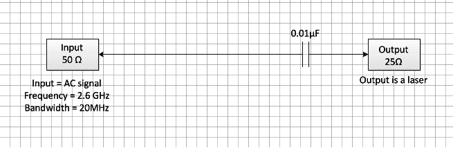

the input impedance value is 50Ω and the output or load is 25Ω typically . so how to match impedance between those two resistor value and the important thing is , use only capacitor and inductor in the circuit. the input signal is RF signal and the output is a laser diode.
Is the signal wideband or one frequency?
the frequency range is 2.6 GHz .

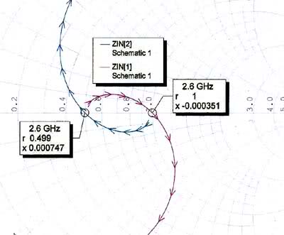

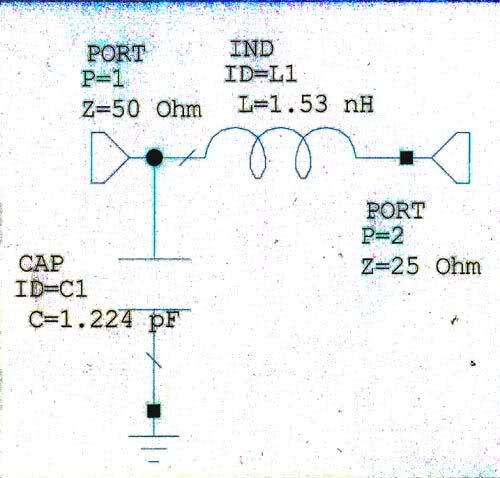

I did not do calculation as you did not ask! I use smith chart and verified by simulation:
As you can see in the left side, that is the circuit and value from 50Ω port 1 to 25Ω port 2.
The right graph is the smith chart simulation to verify that this network work in both direction.

For the low pass network in Yungman's example I get C1 = 1.22 pF and L1 = 3.06 nH.
In my calculation inductor is 1.53nH. I double checked already. And the simulation show that the value got to be correct. As you can see the normalized impedance go between 0.5 to 1 and also the other way back. No if and buts about this.

The one I used is low pass where the cap C1 is on the 50Ω side. then from the junction, it connects to L1 which then connect to 25Ω as shown in the previous diagram on the left.
This is using series to parallel transformation and vise versa. So we know:
[tex]R_p=(Q^2+1)R_S\;\;,\;\; Q_S=Q_P\;\;,\;\; Q_S=Q_P=\sqrt{\left(\frac {R_P}{R_S}\right)-1}\;\;,\;\;Q_S=\frac {X_S}{R_S}\;\;,\;\;Q_P=\frac {R_P}{X_P}[/tex]
[tex] X_P=\frac 1 {\omega C_1}\;\;,\;\; X_S= \omega L\;\;,\;\; R_P=50\;\;,\;\;R_S=25[/tex]
[tex] Q_S=Q_P=\sqrt{\left(\frac {R_P}{R_S}\right)-1}=\sqrt{\left(\frac {50}{25}\right)-1}=1[/tex]
[tex]Q_P=1=\frac {R_P}{X_P}\Rightarrow \; X_P=\frac 1 {\omega C_1}=50\;\Rightarrow\; C=\frac 1 {50\times 2\pi\times 2.6\times 10^9}\;=\; 1.224\times 10^{-12} F[/tex]
[tex] Q_S=1=\frac {X_S}{R_S}=\frac {25}{25}\Rightarrow \;X_S=25Ω \;\Rightarrow \omega L=25\;\Rightarrow L=\frac {25}{\omega}=\frac {25}{ 2\pi \times 2.6\times 10^9}= 1.53\times10^{-9}H[/tex]

You're correct. I mistakenly used 50 as the reactance of the inductor when it should have been 25.

the calculation yungman gave is perfectly fine, but i have a capacitor also in the line in excess, i need to include it, which is 0.01μf which helps to block the dc supply from other side. and also is it possible to increase the value of inductor because the 1.5nH will be available only as SMD component.
the circuit is working fine in 2.6GHz with through hole but the output has high losses, that is the main reason i am taking the impedance matching now.
the capacitor is fixed as per the figure attached to the before post, (please refer to it).

The circuit usually do not "not work", it just has more and more loss as the parasitic components start adding up. Don't think I can convince you that's it's a bad idea to use through hole in 2.6GHz.
The 0.01 cap it ok, don't worry about it. It is going to behave like a short circuit in this case if you don't look at the parasitic. Thing you have to watch out is the lead of the cap which is inductance add to the circuit. One way to use this inductance is to put the 1.2pF before the 0.01uF cap and use the lead inductance of the 0.01uF cap as the inductor. You can try moving the through hole 0.01uF cap up and down to increase and decrease the lead length ( which is increase and decrease the series inductance ) to get the lowest loss. Then just specify the height of the cap on your design.
