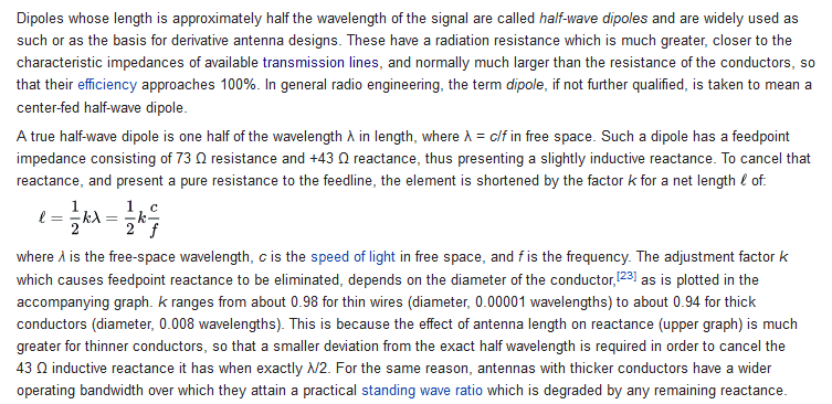

Found this in the wikipedia article:
Radiation resistance is an effective resistance due to the power carried away from the antenna as radio waves.[1][2] Unlike conventional resistance, radiation resistance is not due to the opposition to current (resistivity) of the imperfect conducting materials the antenna is made of.
So I am getting closer to understanding the "AC resistance" that is a function of frequency but it is not really a reactance.

What do you think about this explanation in wikipedia:
Electromagnetic waves are radiated by electric charges when they are accelerated.[2][10] In a transmitting antenna radio waves are generated by time varying electric currents, consisting of electrons accelerating as they flow back and forth in the metal antenna, driven by the electric field due to the oscillating voltage applied to the antenna by the radio transmitter.[11][7] An electromagnetic wave carries momentum away from the electron which emitted it. The cause of radiation resistance is the radiation reaction, the recoil force on the electron when it emits a radio wave photon, which reduces its momentum.[12][13][2] This is called the Abraham–Lorentz force. The recoil force is in a direction opposite to the electric field in the antenna accelerating the electron, reducing the average velocity of the electrons for a given driving voltage, so it acts as a resistance opposing the current.
I am not trying to understand every detail of that but it sounds satisfactory as it confirms that "there is this certain *other* type of resistance" blah-blah which ends up with "electrons being slowed down" for whatever reason => slower electrons => less current => higher resistance. Is there a way to reconcile this explanation with the transmission line based theory you referred to?

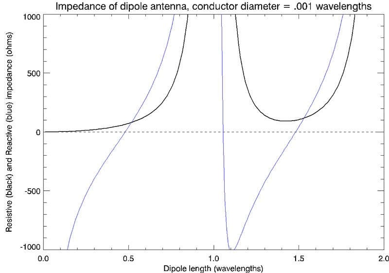

Not 'independant' but slowly varying across the band. (Wikipedia figure)
As the wavelength increases (shorter and shorter dipole) the radiation resistance gets embarrassingly low, which is why there's a very practical limit to how small y our transmitting aerial can be. So much so that the (series resistance) losses in the transmitter and matching network make it very inefficient.
Perhaps I was unclear. The real impedance (i.e.resistance) of a truly halfwave antenna is always 73 ohms. If one changes the frequency without concurrently changing the length it is no longer a half wave antenna.

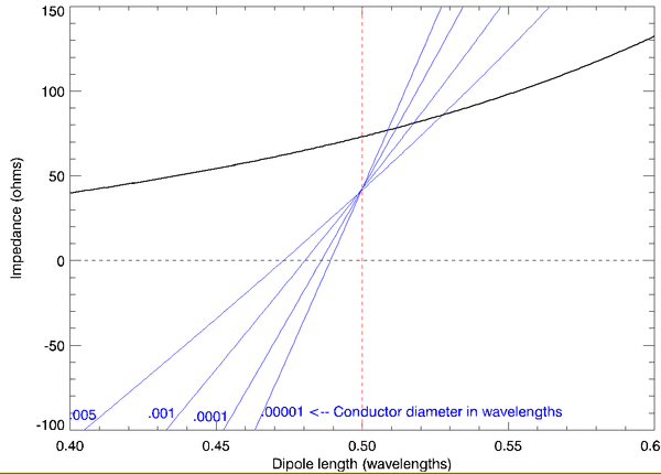

If the dipole was a real 73 ohm resistance, it would get hot. But the dipole does not get hot because it is part of a transmission line. The dipole is a coupler that connects the transmission line to the space around the dipole.
If rather than λ/2, you cut the dipole to a length of λ/3, it will not have a resistance of 73 ohms.
If you use wire thicker than a filament for a λ/2 dipole, it will not have a resistance of 73 ohms.
If you have a dipole with a resonant frequency of 100 MHz it will not have a resistance of 73 ohms at 99 MHz, nor at 101 MHz.
