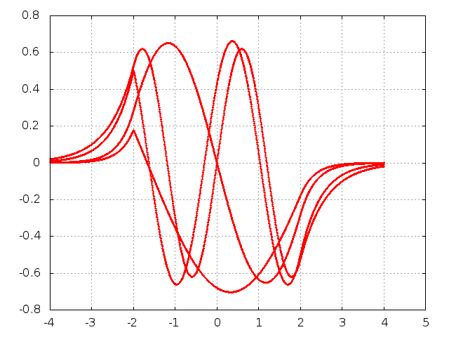

I want to solve the Schrodinger via the Numerov Method but I had some troubles. I'm programing in C++, so here is my code:
Code:

The code compiles perfectly but the problem arises when I want to plot the odd solutions. I obtain two satisfactory solutions but another two that it's function is continuous but not it's derivative.
I would be very thankful if somebody can help me with this problem.

Basically the code takes all the energies, i.e. $0<E<Vo$ and the fuction "Biseccion" applies the Bisection algorithm between an energy $E$ and $E+step$. So the fuction finds the eigen-energy for which the left and right (from the Numerov Method wave functions matches.
Here is an example of the plot that I obtain:
As you can see, there are two graphs that are not a satisfactory solution to the problem.

It seems like the absolute value of the derivative is the same at thepoint where it is discontinuous. Check your PAR factors to see if you don't have too many/too few.
