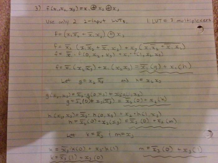

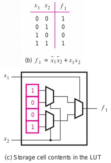

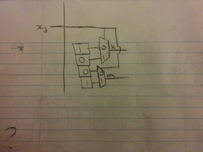

I am unsure how to proceed from here. Here is what I understand LUTs to look like:
Here is my attempt so far:

Do LUTs need to look exactly like this below? Or can LUTs be any sort of box that has 2 inputs and 1 output?
Also, do LUTs need those pink squares? i.e. stored 1's and 0's inside the LUT as memory.
